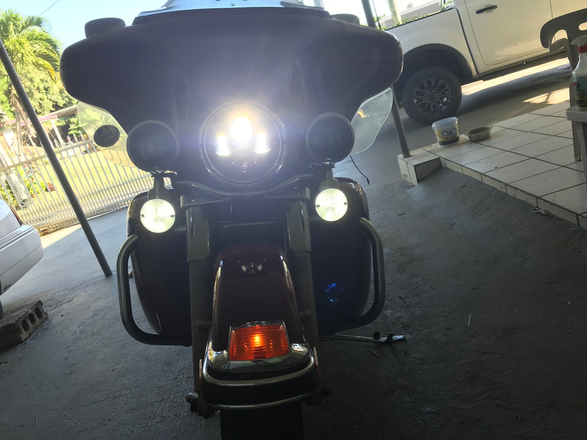

Switchbacks
How can I stop hyper flash without bustin my wallet?
