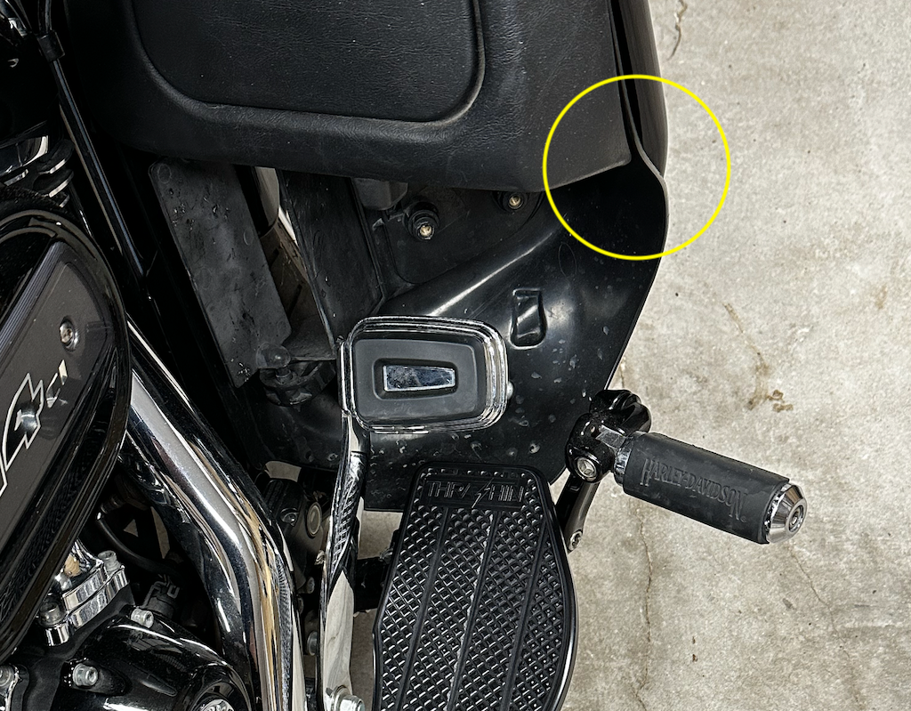

this may help you some. i have air cooled bikes, not twin cooled. but, i did purchase the amazon tcmt lowers in vivid black (less than $100), but the advanblack lowers in industrial grey denim. what i found is that the lowers themselves were virtually identical to each other. if not for the paint, you would not know which is which.
now, the story doesn't end there though. the tcmt/advanblack lowers come with some cheapass textured plastic on the glovebox. i hated that. so i ordered the upper glovebox parts from hd and swapped out most of the parts, only adding about $100 to the cost. i was able to save money because i also found a take off set of gloveboxes so i've switched the gloveboxes on both the advanblack and the tcmt lowers. they aren't 100%, but close enough that unless you knew what you were looking for, you wouldn't notice. and since lowers are so close to the road and get blasted by road dirt, grime, etc. i'm not worried over the small stuff.
here's pics to give you an idea:

That’s awesome! My theory (which makes sense) is that advanblack took a set of HD lowers copied every part from them to make their own, using cheaper materials, off course, as I’ve read they are made of thinner plastic. I just needed to make sure factory HD parts would bold on to the advanblack painted shell.
what do you think isn’t perfect, the fit or the finished? To the HD parts align well?
Thanks man, this is exactly what I am looking for!!!

the fit isn't 100%, mostly in the area that i've highlit. and the vent door is a little off as well. but nothing that i can't live with.
