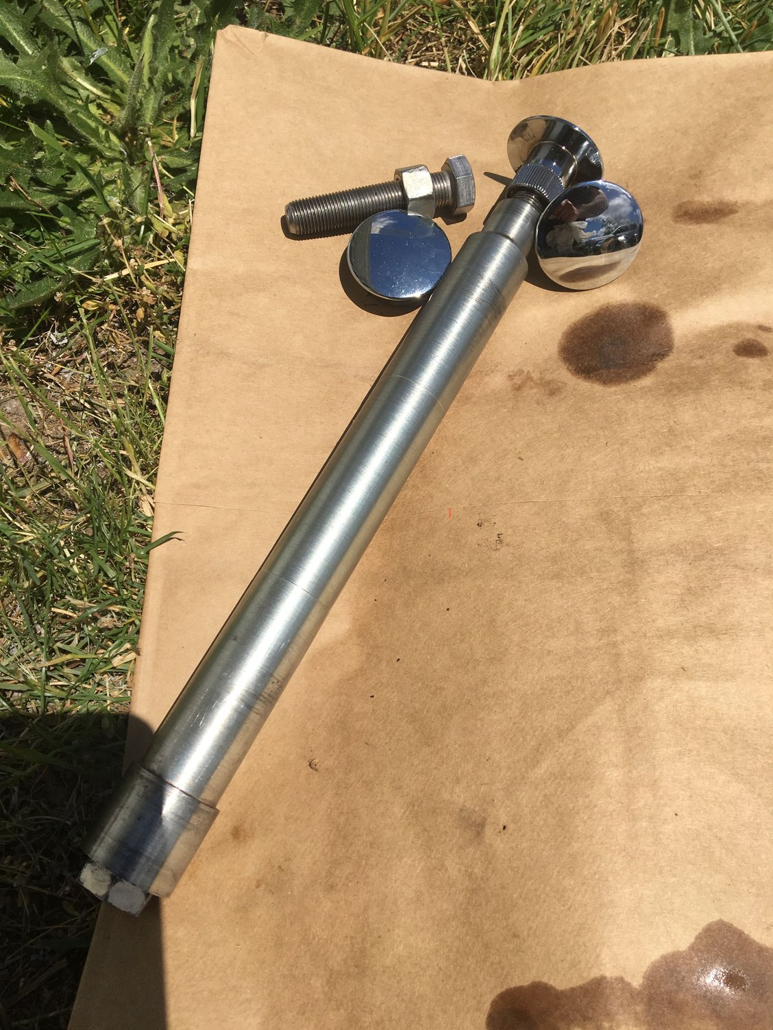

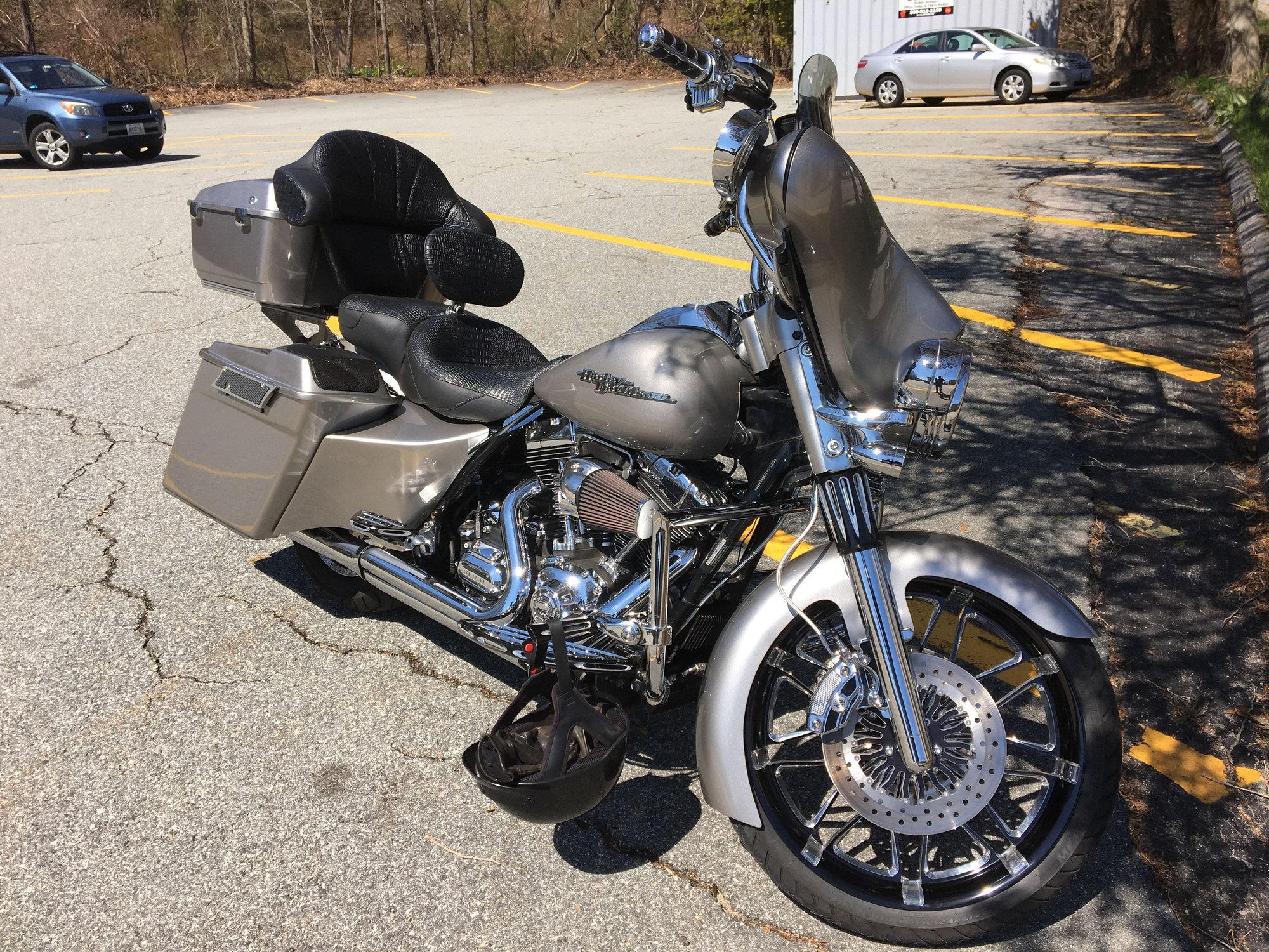

If those axle covers are getting pitted, then probably your forks are too. No downside really on the flush mount axles, just depends on the look you want. Another option is a cleaner look with the Arlen Ness hot legs in the second pic. I have those H-D chrome "hub caps" and no pitting in the 10 years I've had them.
Flush axle by Klock Werks.
Arlen Ness Hot Legs

Flush mount axel requires press fitting a “captive nut” into one side of the forks and then torquing the axel to the required spec. Another cap is pressed over the torquing nut and clamped from the bottom. Just beware that when and if the time comes getting that captive nut out is a pain. I’ve had both set ups and eventually settled for the Hot Legs.
