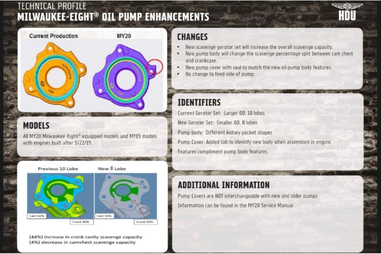

I would not own an M8 without the newer, 8 lobe gerotor oil pump introduced in May 2019 and included on all 2020 models.
While not an absolute cure, it seriously lowers the chances of a sumping issue...

Everything Ive read states that the 2017 oil pumps were the worst of the lot and really should be replaced. Is this just fear mongering?

If money is the issue what you need to do is save some funds then buy the parts as you can afford them. Buying cheap usually means not good quality, so slow down and get all the parts as you can afford them. Since you have a 2017 and you plan on keeping it an Oil pump is a must have item.
1. HD OEM 2020 or later Oil Cooled oil pump assembly
2. New Lifters and I have had very good luck with AC Delco HL 124 or GM # 17122490 parts
3. Koyo Cam bearing # B-168
4.Camshaft that fits your riding style
TTS -100 if your after great lower RPM torque and mid range with a smooth style idle sound.
TTS -175 if your after good lower RPM torque and great mid range to higher RPM and will give a hotrod style idle sound.
5. Necessary gaskets (valve cover, cam cover, tappet covers ect.), oil and filter
6. Adjustable pushrods if you don't want to remove the valve covers to remove the original pushrods. I've had good luck with the SE adjustables
