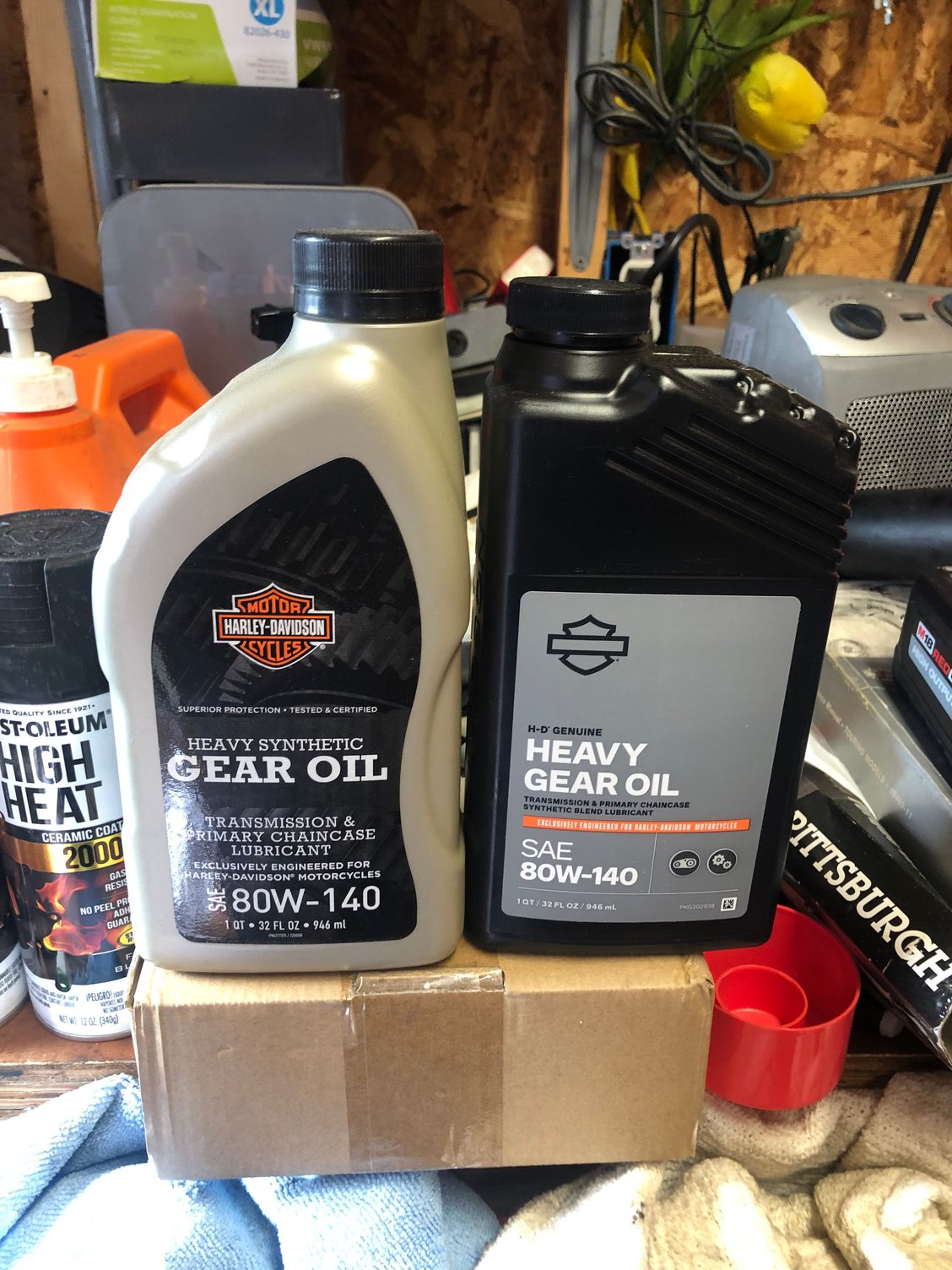

Harley keeps changing bottles is this the same. I am using this for my 2011 flhp and I know it takes more than a quart thanks

There is no way of knowing unless you send it to a lab.
But I wouldn`t hesitate to use either one, or mix.
Harley quietly switched from one to the other.
I don`t think any 6 speed transmission takes more than 1 quart...

I say "run it"
No worries

Just looking at the labels one says heavy synthetic and the other says synthetic blend. I'm not a chemical engineer so I can't say whether it hurts to mix them or not.

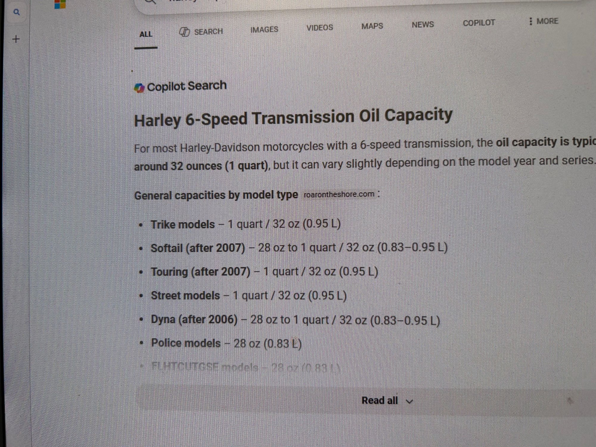

Here are the capacities
consider that no one is "flushing" out the old spec before adding the new spec so "mixing" doesn`t matter

You mean, here are the capacities according to AI....
Exactly
And much like mixing the 2 bottles, I`m not overly concerned about + or - an ounce or 2 in an oil bath / splash box

Well in my notes to fill it was a little more then a quart. I thought possibly that same velocity and synthetic. I hate to spend another 20 bucks. I will drain it first fill up to the diaphragm like the manual says but it does say more then a quart
