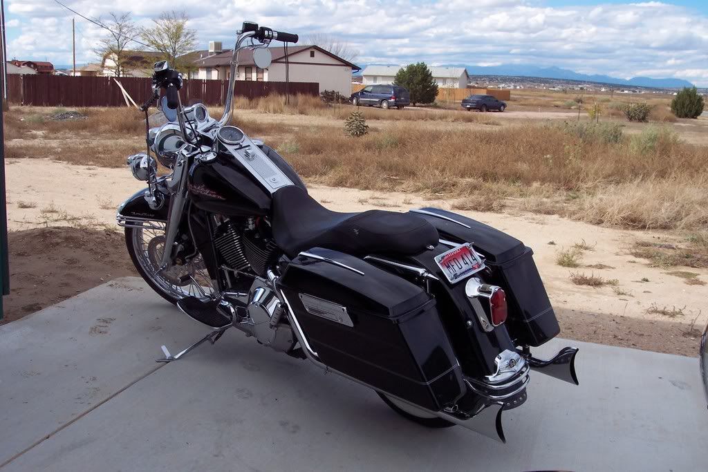

Nope it wont work, Oh wait yes it will I had one on my Road King. I reused the stock hub and laced the 21 to it. NO SPACING ISSUES WHAT SO EVER! That being said it is a small tire for a big bike so you must ride appropriately! You have more brake than tire traction. Sorry this is the best picture I have.
DO NOT run the softail or wide glide hub with only one brake, that is begging for an accident!!!!
