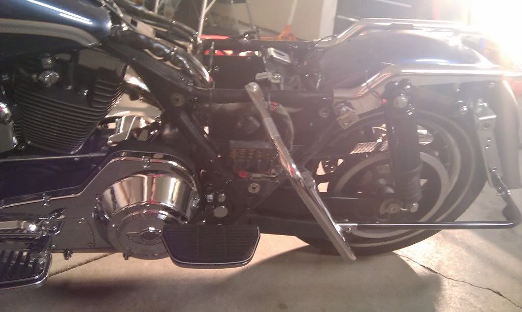

Couple of pics for fun.
You can see in the below image why I am replacing the rear fender.

Anyways made a little headway tonight. There is one bolt left to take the rear fender off that I can not get to. The tire is in the way. I tried deflating the tire to see if I could get enough space in there with no luck. Does anyone know a good way to get to this bolt without taking the rear tire off?

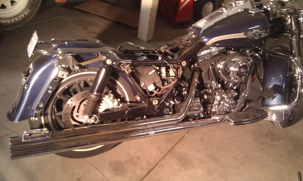

Here are some pics for fun.

1. you are going to want to drop the wheel anyway, there is wiring clipped to the underside of the fender you'll want to get at, give your self room.
if you disconnect the shock bolts at the swingarm, the wheels can drop down some-don't let it free-fall.
and that may be enough room- or it allows you to get at he axle bolt rather than pulling the exhaust pipes.
