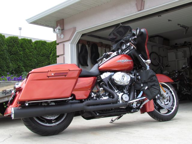

Well after two weeks of (not so) patiently waiting, I finally received the V&H HO ProPipe and PC-V in the mail from Fuel Moto.
Pipe only installed at this point, A/C is on backorder from Performance Machine for another week yet I'm told.
WOW nice sound!! Soooooo much better than the stock setup that sounds like a pair of XR 80's lol. Nice and deep tone, mellow at low throttle but really barks in the upper RPM, couldn't be happier.
HEAT though.. holy snappin arseholes... First call Monday is to add the heat shield to the Woods 555 cam order from Jamie and the gang lol.
Here's a couple pics, transformation is beginning....
Attached Thumbnails ProPipe Installed..-img_0099.jpg   ProPipe Installed..-img_0100.jpg   ProPipe Installed..-img_0105.jpg

Looks great! I think you're gonna be very happy once you install the A/C and Triple Nickels. It'll run much cooler as well!

Thanks.. Yes I'm hoping the heat comes down, could bake a potato if ya bungeed it to my calf lol. One pita is it sounds like I have a small exhaust leak but both headers are clean, no mess indicating exhaust s leaking from anywhere around the header/head insert..

Looks great. Love my pipes
Check the bolt on the back side of the pipe by the rear cylinder
Mine came loose after a couple hundred miles and it rattled and sounded like an exhaust leak

Well I wnet back over the pipes from front to back, loosened off all the connections and re-torqued front jug first, then rear, then to header/megaphone connection. WAY quieter, to the point where I think anything I hear is in my head.. That and the heat is noticeably down, guessing the air leak caused a lean condition which = more heat.
