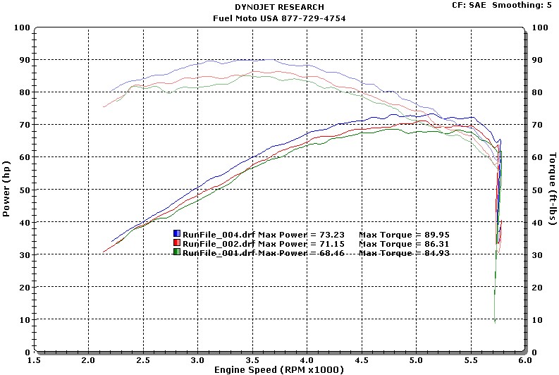

Here is a test we did with our 2011 Road King 103" completely stock. This chart compares the stock catalyst head pipe (Run 1 green trace), a stock non-catalyst pipe (Run 2 red trace), and the Jackpot 2/1/2 stainless head pipe (Run 3 blue trace). These were back to back tests done on the same day, each test was conducted at a 200 degree ET, and IAT was 110 degrees.
While the differences are already apparent on the completely stock bike, they become even more significant with intake, mufflers and tuning.

Re: the chart....Is the upper run (at 80hp or so) with dyno tuning, pipes, mufflers, etc?

So performance head pipe vs. stock is roughly 4-5rwhp and 4-5ftrwtq UN-tuned and with stock?? mufflers?
