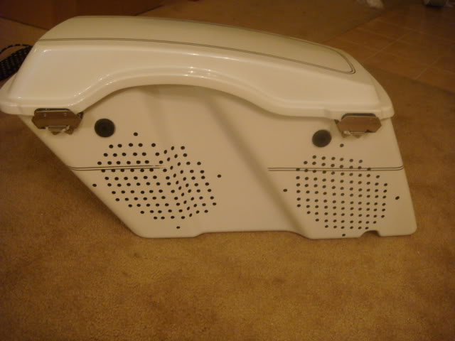

I have 2 Pioneer 6 X 9's in each bag. They sound better since I had an upolstery shop carpent the bags & lids !
A LOT nicer finish than the HD liners, and about the same price.
