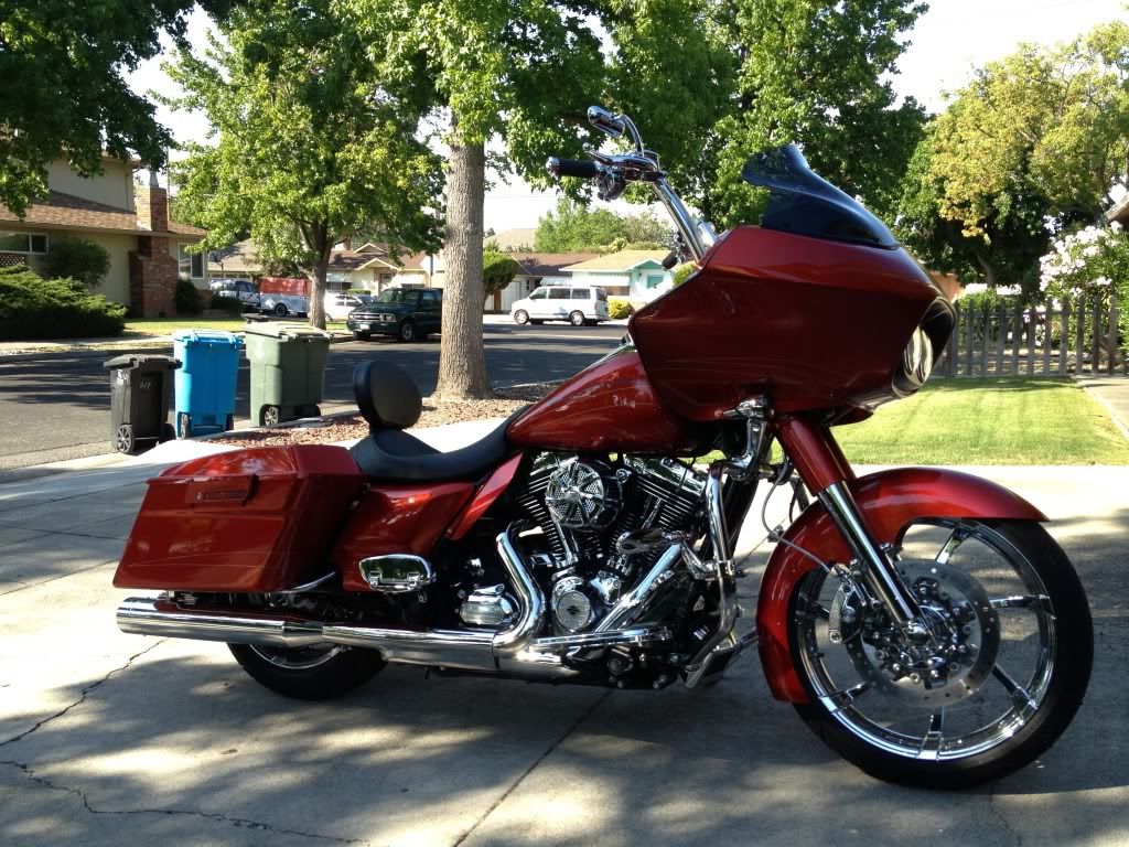

Here are a couple of pics, just cause...
