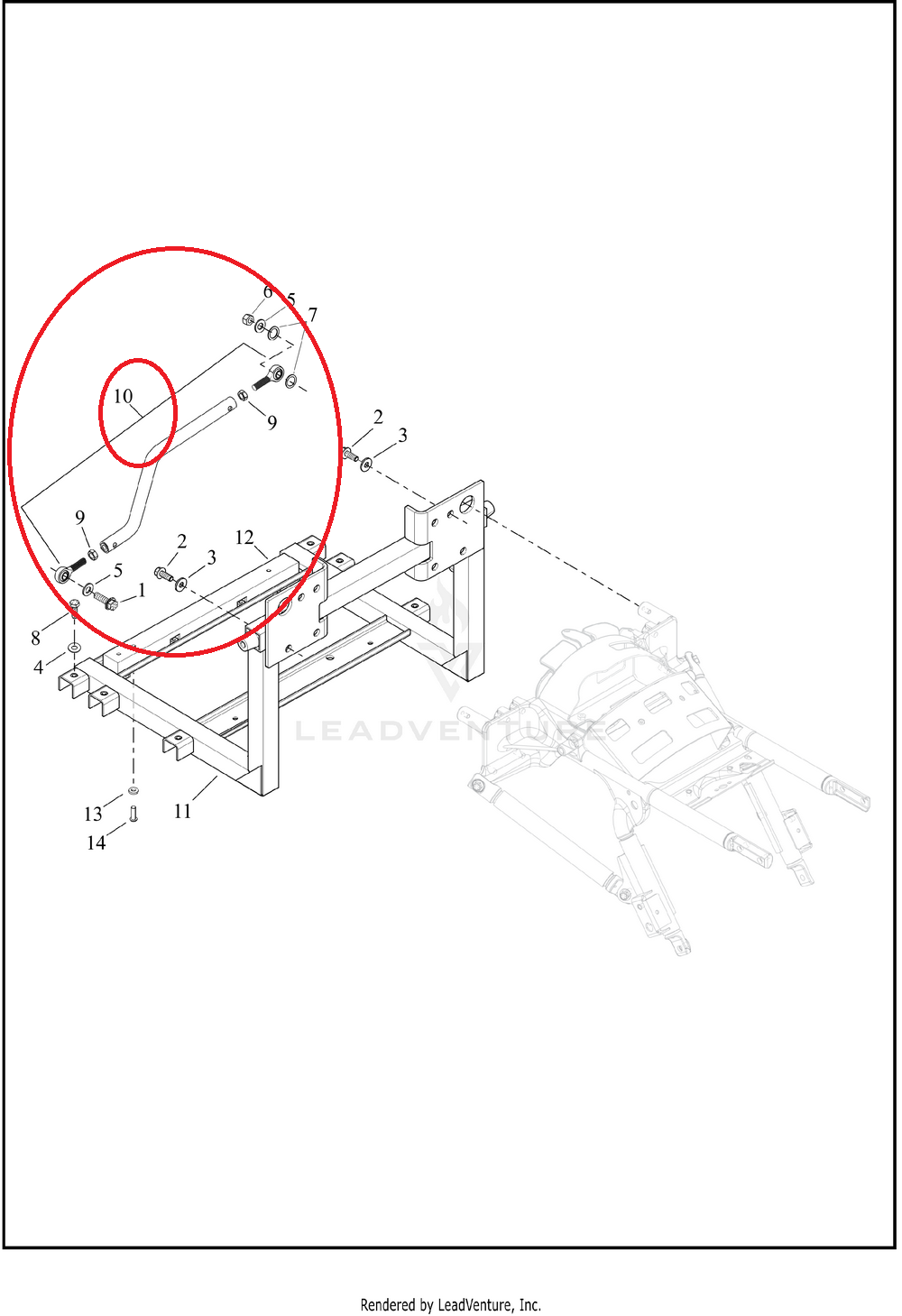

Interesting. I have 41k on my 2019 and I have never thought to check those heim joints.
At just $25 for both seems like a no brainer......
1/2 X 1/2-20 Chromoly Teflon Kevlar Male RH Rod End XMR-8 – QS Components, Inc.
Thanks for the details!

Are the heim joints on each end RH? So the one part # x2 is what to order?
I am not equipped to replace them myself but I would buy and have my indy install.
Thanks
Originally Posted by CoolBreeze3646
I used the better quality one in your link. No play now.
From the Harley Parts website, you cannot buy the individual ends; however, with the part number stamped on them you could get OEM aftermarket ones but they are not the same quality as the ones in your link. It only lists the entire assembly for $295.56 - F-that lol.

Order 2 😉
I ordered new lock nuts also.
You can reuse the old ones if you want.
https://www.qscomponents.com/products/1-2-x-1-2-20-chromoly-teflon-kevlar-male-rh-rod-end
https://www.qscomponents.com/collections/standard-steel-jam-nuts/products/1-2-20-steel-right-hand-jam-nut
Thanks
Yes both are right hand thread. Order the ones that are linked above. You only need 1 jam nut per rod end and can use the old one with no issue.
