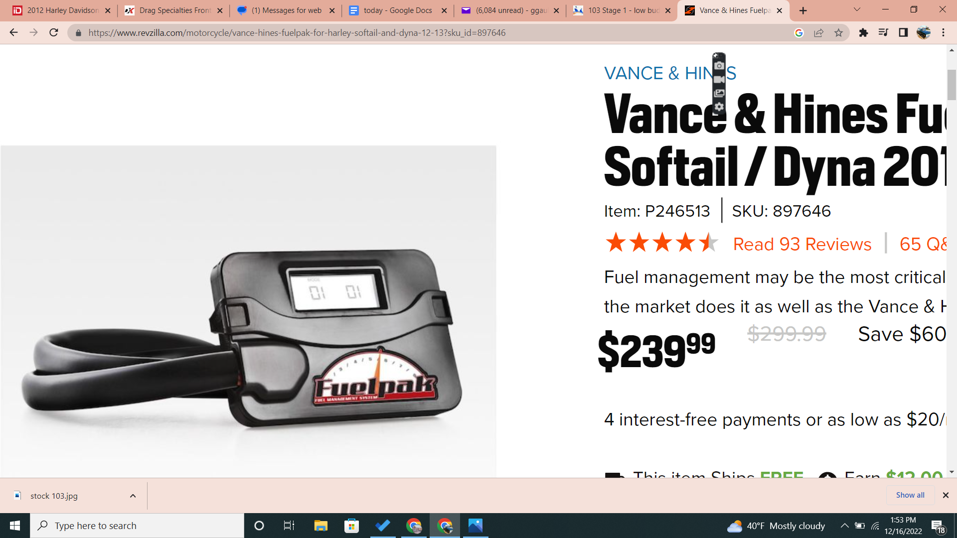

This week in TUNER NEWS
It appears that a mechanic near me has 3 of these old school Vance and Hines (NOS)... he'll sell me one for $75.
Seems like this "low budget" thing may happen!
(Let me know if you want one.... I can put you in contact with him.)

If you really are on a tight budget you could look at the XiED or ViED or whatever you bike needs. A device to fool the ECM to inject more fuel.

If you're on that tight of a budget just save your money at this point. Keep saving money until you can do it right. That "tuner" is a POS. Why do you think that your mechanic has 3 brand new ones and is willing to sell them for 75 bucks? Is it because he's a great guy and he really likes you? No...its junk and he'll take anything at this point to get rid of them. Sorry for being harsh but really don't waste your money. You can probably modify your current air cleaner by removing the back plate and using a high flow K&N type filter combined with at least a slip on exhaust...look here for something used...and the most critical part is a good tuner. Buy once cry once. Get a power vision from fuelmoto. That way it'll be able to grow with you as make changes and fuelmoto will give you maps to match your setup.

@Screamin beagle he is correct about the PV. I have one and it does do a very good job.. Especially when it comes to more motor upgrades.. The fp3 I recommended really only supports stage one and some cams.. Not much else.. The PV will adapt to most anything out there. It's a shame the price doubled in the last 2 years.. duck Joe Biden...

Default 2012-2013 Fuelpak reviews
The reviews are actually pretty favorable for that 2012 Fuelpak.
Guessing that it'll help.

Are those real reviews? It's your dime...
