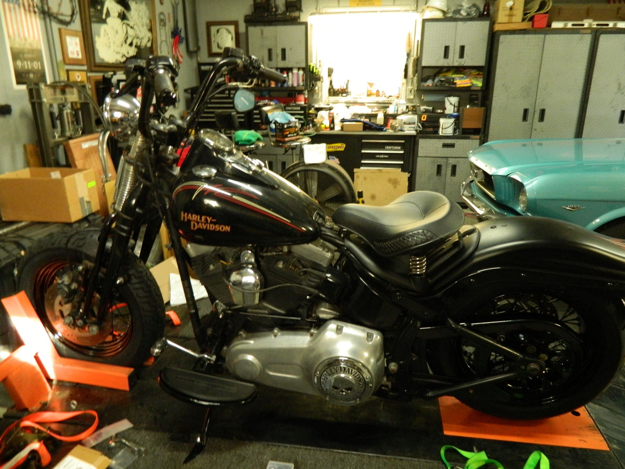

Interesting. How is the rest of the bike doing? I just saw the pics with the seat on it. Not bad, not bad at all.
I'm going to give it a test ride tomorrow. I know there are electronic issues. It has a VIN Err and fuel gauge or not registering on the cap or instrument. I'll ground it (jump) and see if anything changes.
It has an aftermarket tuner that I took out of the loop and nothing changed. From here it's about sorting out those issues and testing ride quality, before moving on to the full fenders and paint.

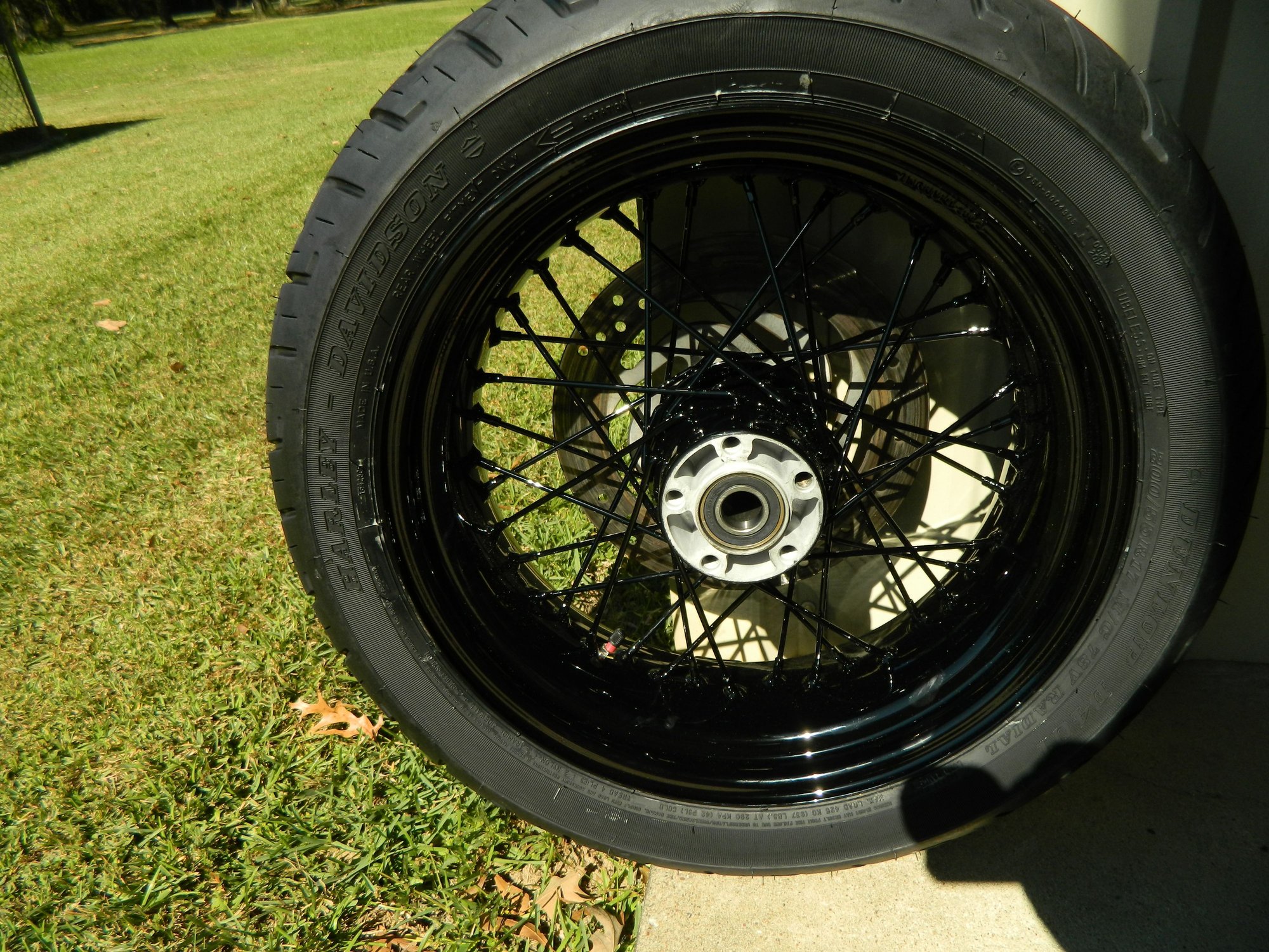

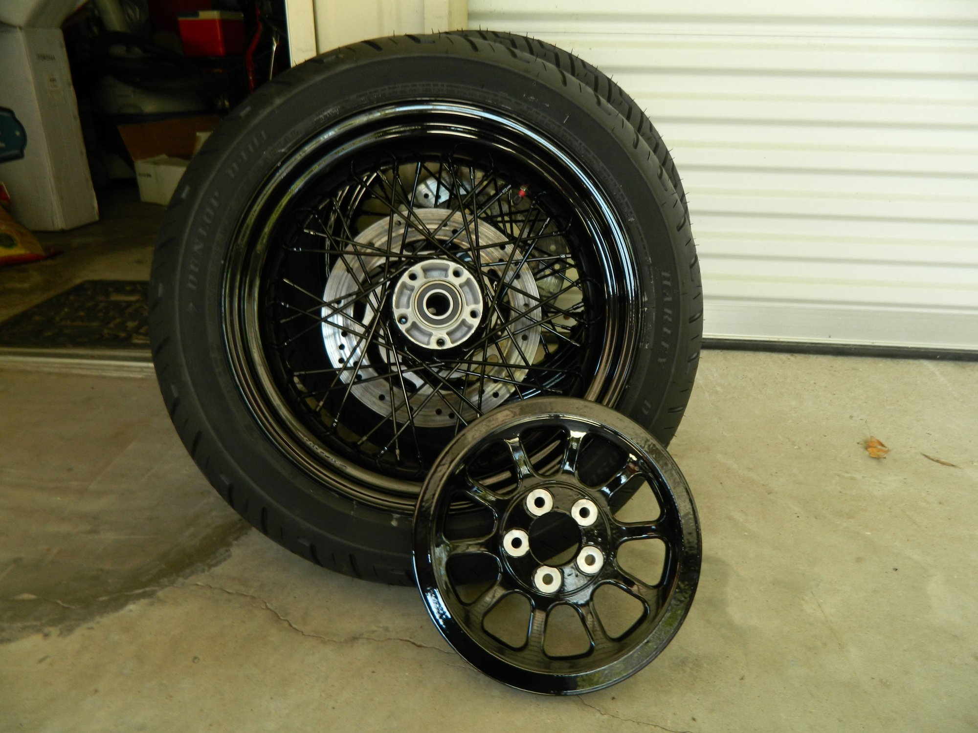

Originally Posted by TSheff
OK just got the wheels and other parts back, think they will be OK. Yes that is a 200 rear tire.
So you PCed them without taking them apart?
Old Oct 22, 2025 | 10:54 PM
TSheff's Avatar
TSheff
Posts: 11,307
Likes: 3,630
From: SE Texas
No. I removed the tires, bands, rotors, pulley, and bearings. I check both rims on the trueing stand before having them coated. I installed new bearings and put the rotors on so the new bands, tubes, and tires could be put on and balanced. I took the pictures after bringing them home from having the tires done. Also had the belt guard, floorboards (after taking the pads off), and jiffy stand coated.

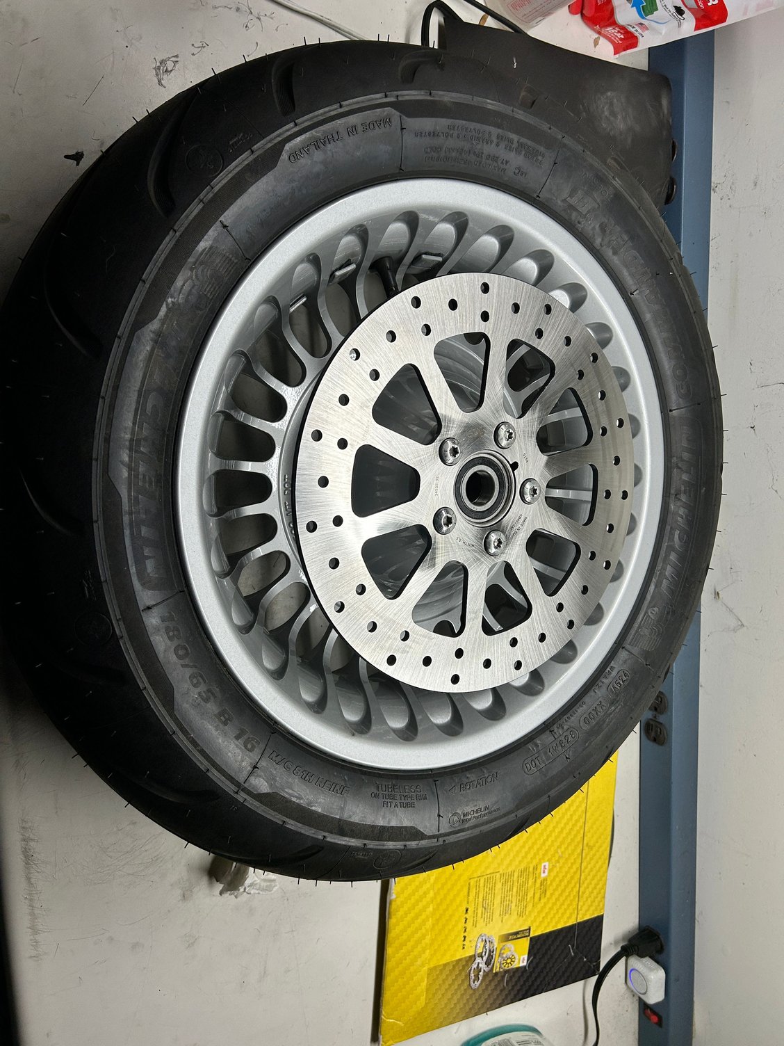

It has taken a while but the wheel is complete. The rotor is not a fancy rotor but it is better than OEM IMHO.
I think that the wheel turned out well.
