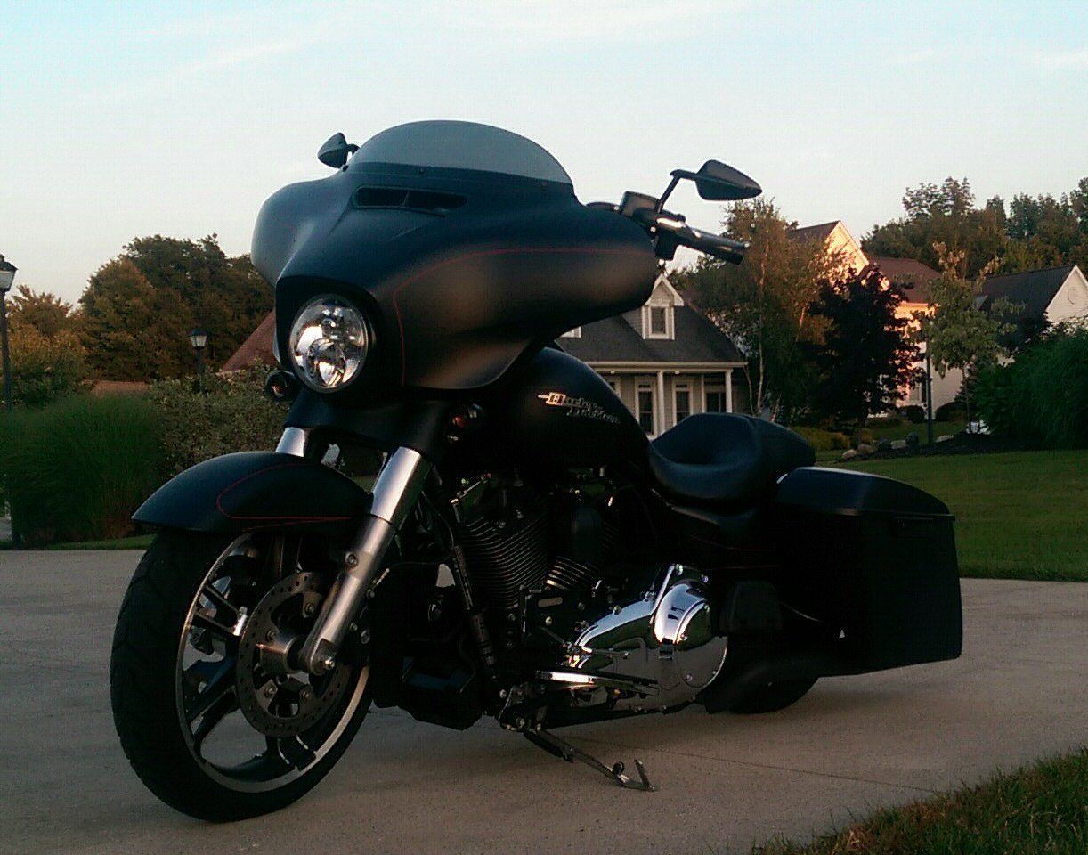

Front lowered 2" , rear air ride
Used the progressive kit in the forks...dropped it 2". Air ride on the rear allows me to be flat footed when in town..Air up for hard riding and adjust for passenger. 5k miles on air ride and 2k miles on forks with zero issues. Handles great.
You're bike looks really good! But be very careful running it without the engine guard, dropping it could get expensive.
