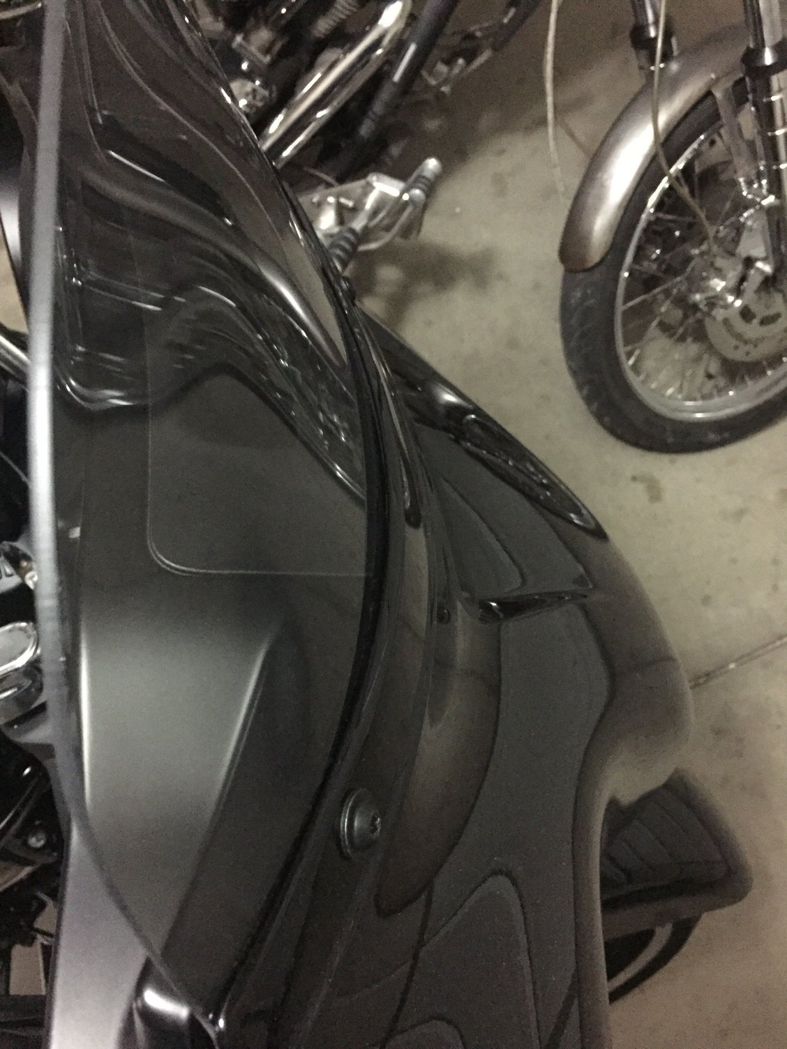

Has anyone else had a small issue with fitment after install? Mine works amazing, but when I installed it I noticed the curve doesn't quite match the fairings'. It's very small but given my job, I notice stuff like that. Not a big deal, I have two more LRS's coming; I was just curious.

It is a known issue with all windshields on the 2014 (and I assume 2015). Freedom shield helps a bit because it is thicker.
