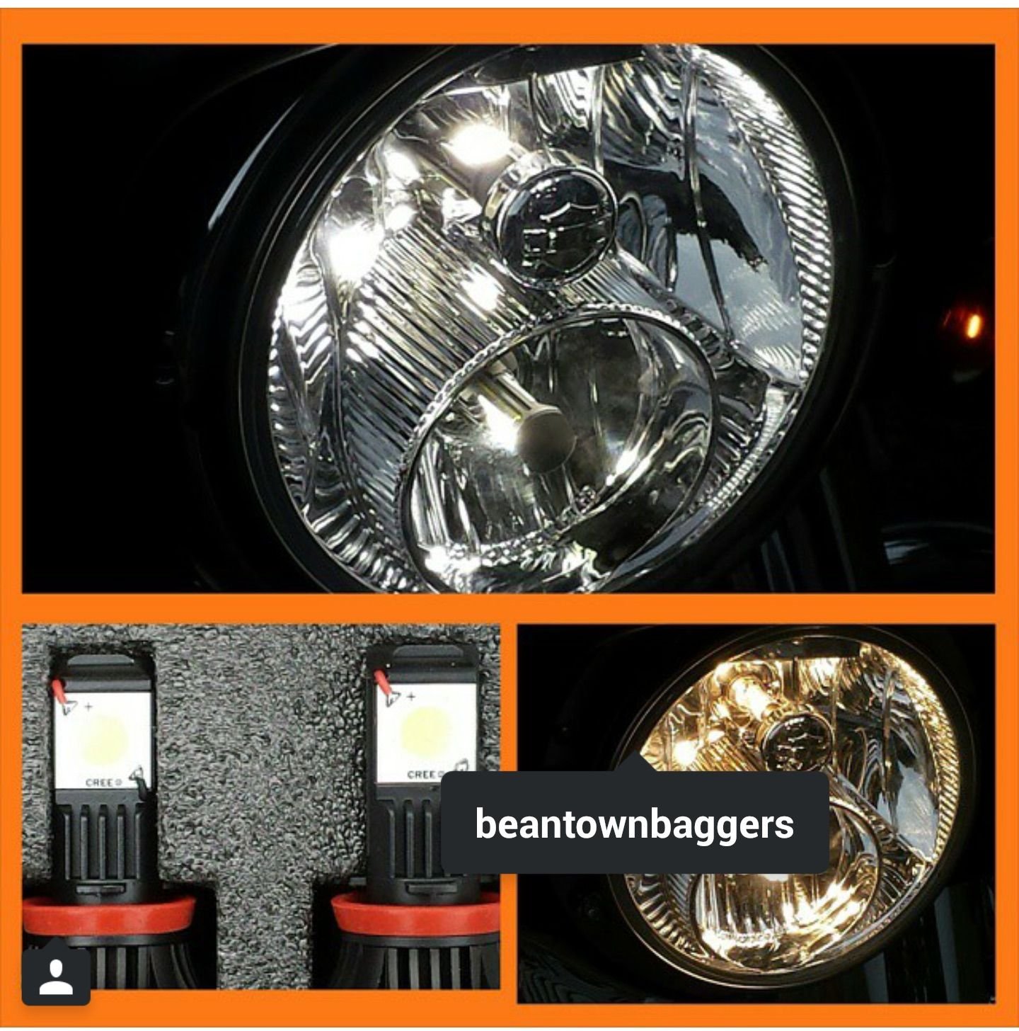

These are the bulbs I used. Bottom right is stock and Top is LED replacements. Much nicer color
Nice!
Do these throw a code?
Went to Beantown Baggers and could not find anyplace where they sell these - can you link me to where they have them want to check them out
