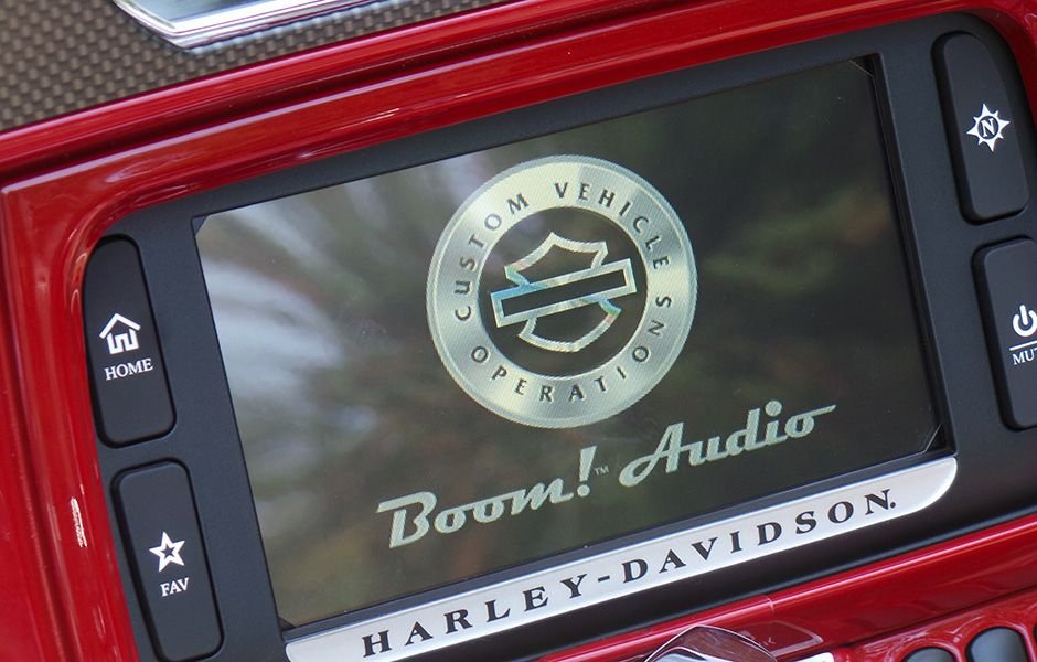

Is this the CVO "splash screen"?
Yes, that is the splash screen
