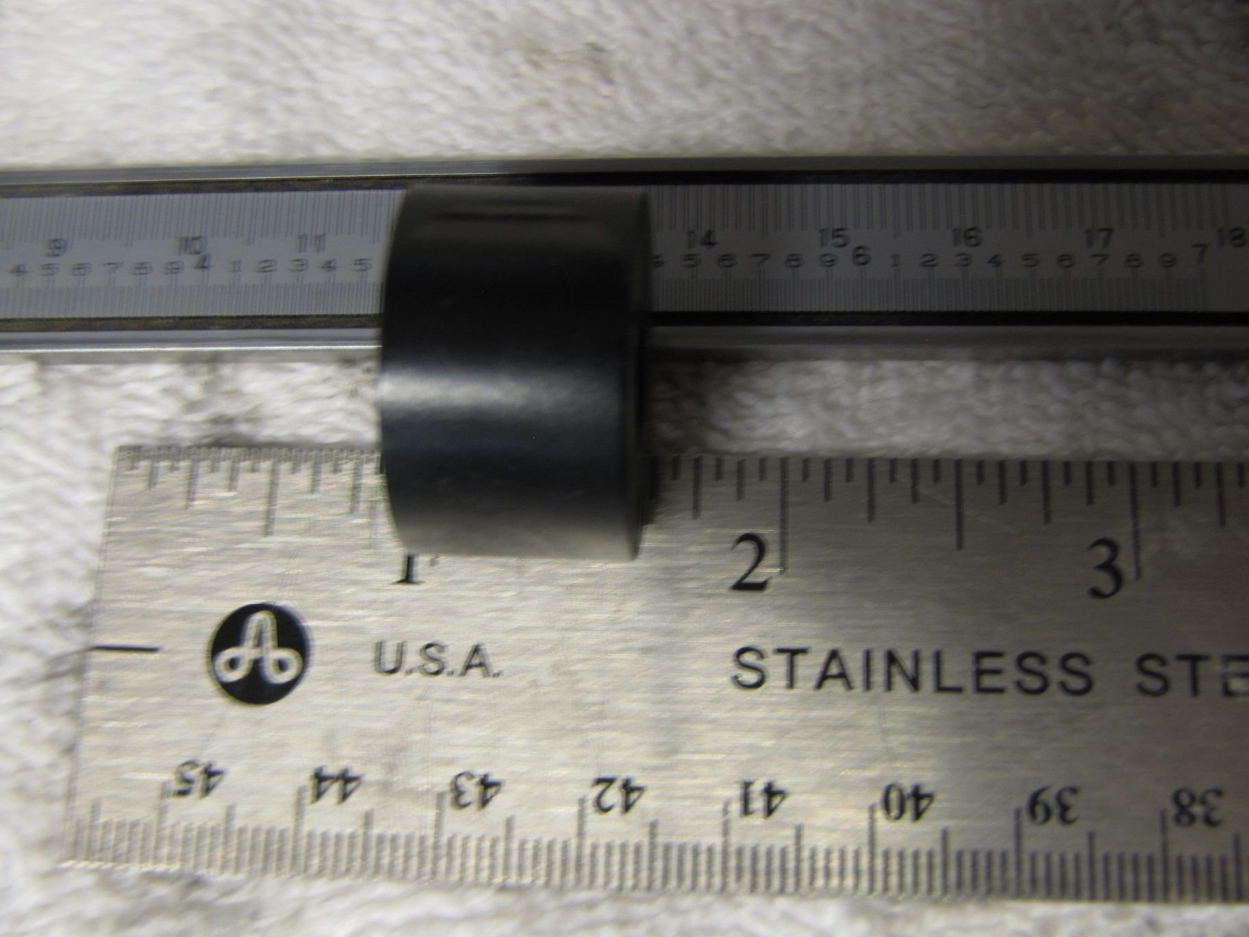

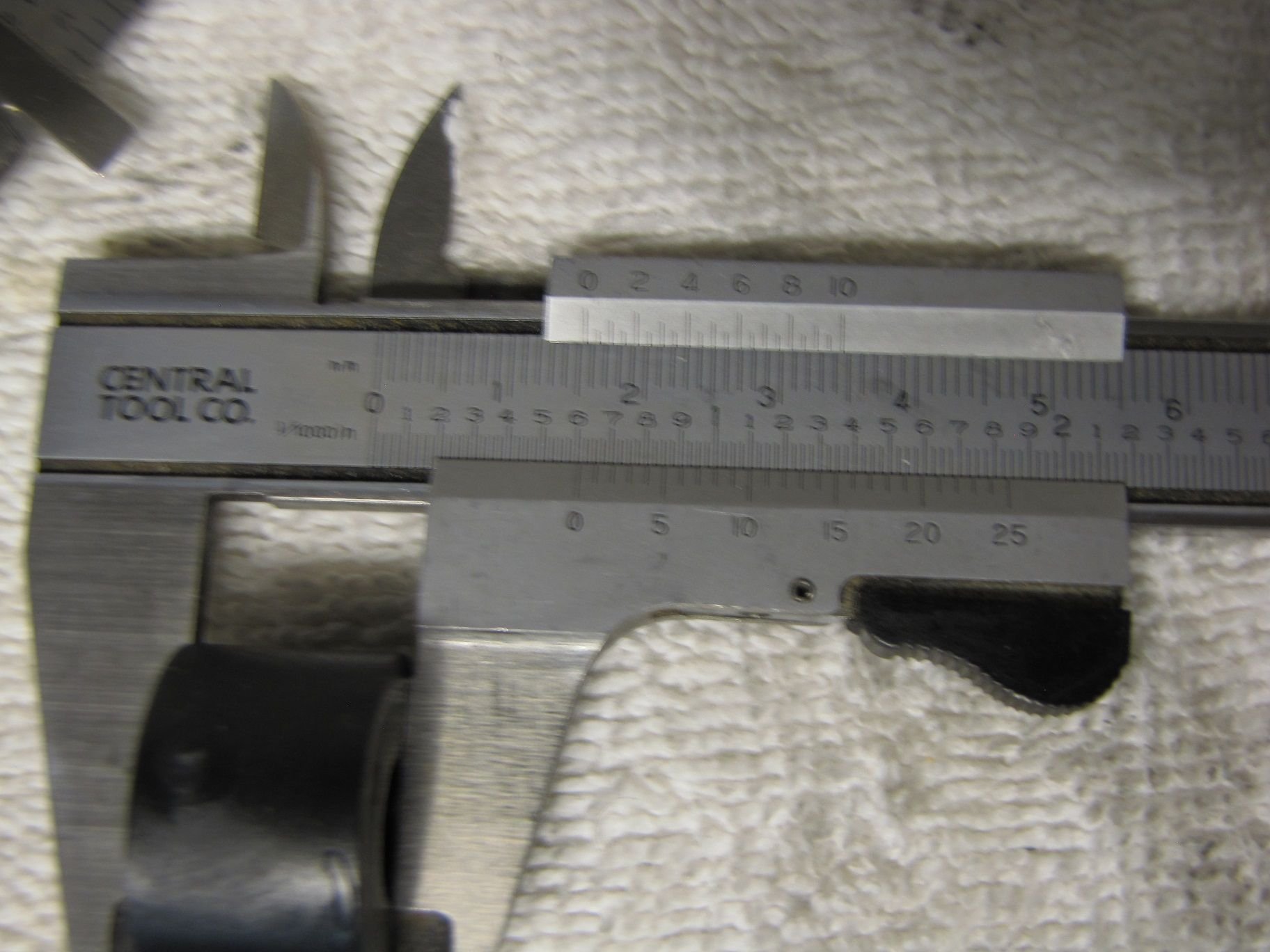

Thanks. I see that is looks like the filter is the only difference. Also it looks like there is a small spacer(red arrow in pic below) that goes on the bolt between the filter and the outer cover. Any chance you could measure yours?

[QUOTE=Nightrain04;14813157]Thanks. I see that is looks like the filter is the only difference. Also it looks like there is a small spacer(red arrow in pic below) that goes on the bolt between the filter and the outer cover. Any chance you could measure yours?
Nice catch on the spacer.
1" wide
5/8" height
3/8" hole
Good Luck
Bill
