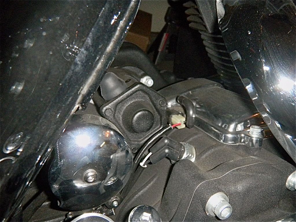

Originally Posted by babygorilla
So, I took a short ride running errands this weekend. Stopped at my bank about 10 minutes from the house, went in, did my business, came out, hopped on the bike and went to fire it up., cranked once, sounded weird, so I let off the starter. Hit the starter again after a second or two and NADA. Tried a few more times, still nothing.
So I take her apart, run across the street, and borrow a jump pack from the mechanic there. After 15 minutes, still nothing, but it is buzzing, radio playing, and when I hit the starter button I get that startup buzz... HMMM. Either starter has died or electrical issue.
Call for a tow (everyone at work that I can get a trailer from and hell, I got a free one anyway), since it's a little to long to push. Checked fuses, all okay., Tow is 2 hours out, UGGH.
Push it into the back parking lot behind the bank (church overflow), Put things back together, and starting going over all the wires. Reach under the rear jug, happen to graze the damn plug into the starter and the thing pops off the starter. Plug it back in, Bike fires right up. Call tow company, cancel tow, ride on home to ensure I don't get fooled again. Fires up alright multiple times, head out to finish my errands.
TL;DR The damn plug going into the starter motor doesn't lock in very well, make a habit of checking it, and if you have power, but not cranking, start there.
Do you mean the thick gauge wire that's on a thread pole and tightened down with a nut, which has a rubber boot cover over it? Can you attach a picture of the plug? Thanks.
That heavy wire is the positive battery cable. That better be tight. The plug in connector (white) goes to the solenoid. If it helps, the vent hose for the trans is right near it.

Originally Posted by Dudlee
Thanks for the info.. Easy enough to check..
Yep, the white plug is the offending SOB....
Got it now! It was drawing a blank to me when it was called a plug. Thanks for the picture. .
