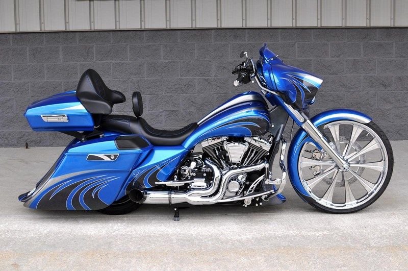

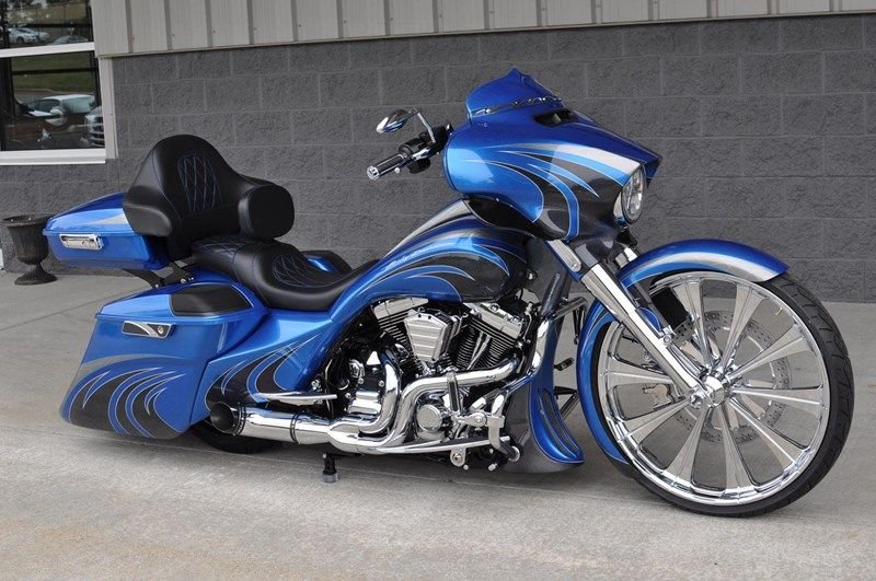

I cannot find the highway bar in the these pics. Does anyone know what it is? I though it was a Lindbar but it is not. The Lindbar will not work with my Brouhard floor boards.
Thanks in advance

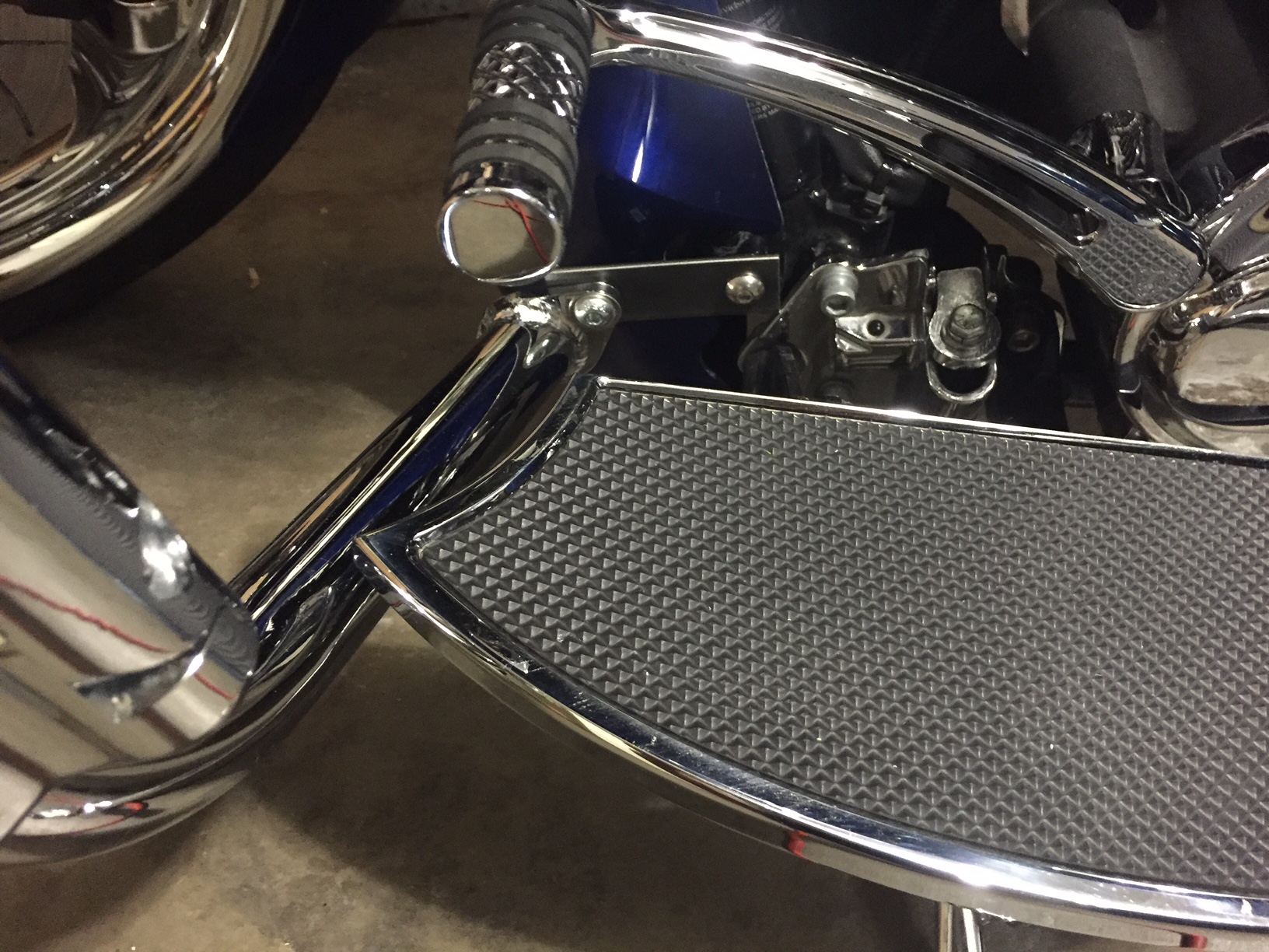

It is a Lindby engine guard - I have their engine guard on my bike - what I did was use a 1" wide piece of flat bar stock, cut & drill it to the length I needed and clear the floorboard - if you have any questions hit me up.

It appears to be a Lindby Customs MULTIBAR - 1302/09: For Harley Davidson Dresser, Street Glide, Road King Models 1997-2016 (except Ultra Limited) with the rubber pads taken off.
