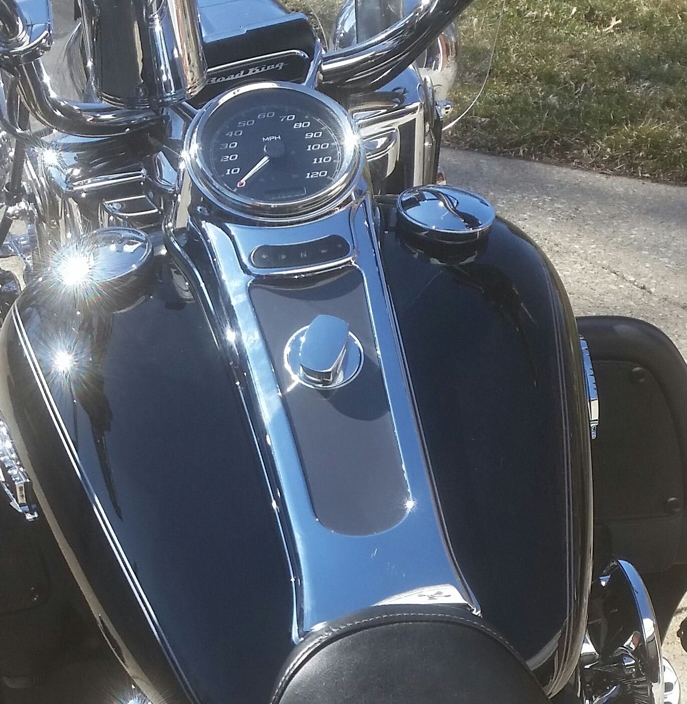

Just as JMC22 said, it was plug and play. Installed the new console, started the bike and my mileage was there. Also, as said, trip B had 31 miles on it that counted down to 0 and wedding bells rang. So I guess maybe the dealer attention it may need only applies to older models. Or they are completely wrong. Who knows.
Looks real good. Now I have to replace the fuel and voltage gauges. That I'm not looking forward to. I think the fairing has to come off. Yay. I may wait until the bike goes in for the ohlins fork cartridges I'm waiting for and let them do it since the fairing has to come off then anyway. I'm pretty friendly with the service director so he won't bend me over (I hope)
The new gauges are backlit white. Looks really slick.
