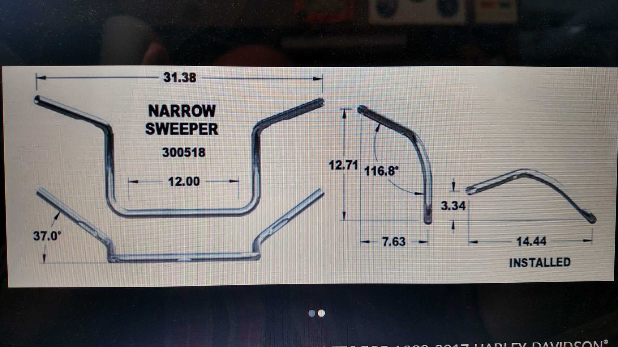

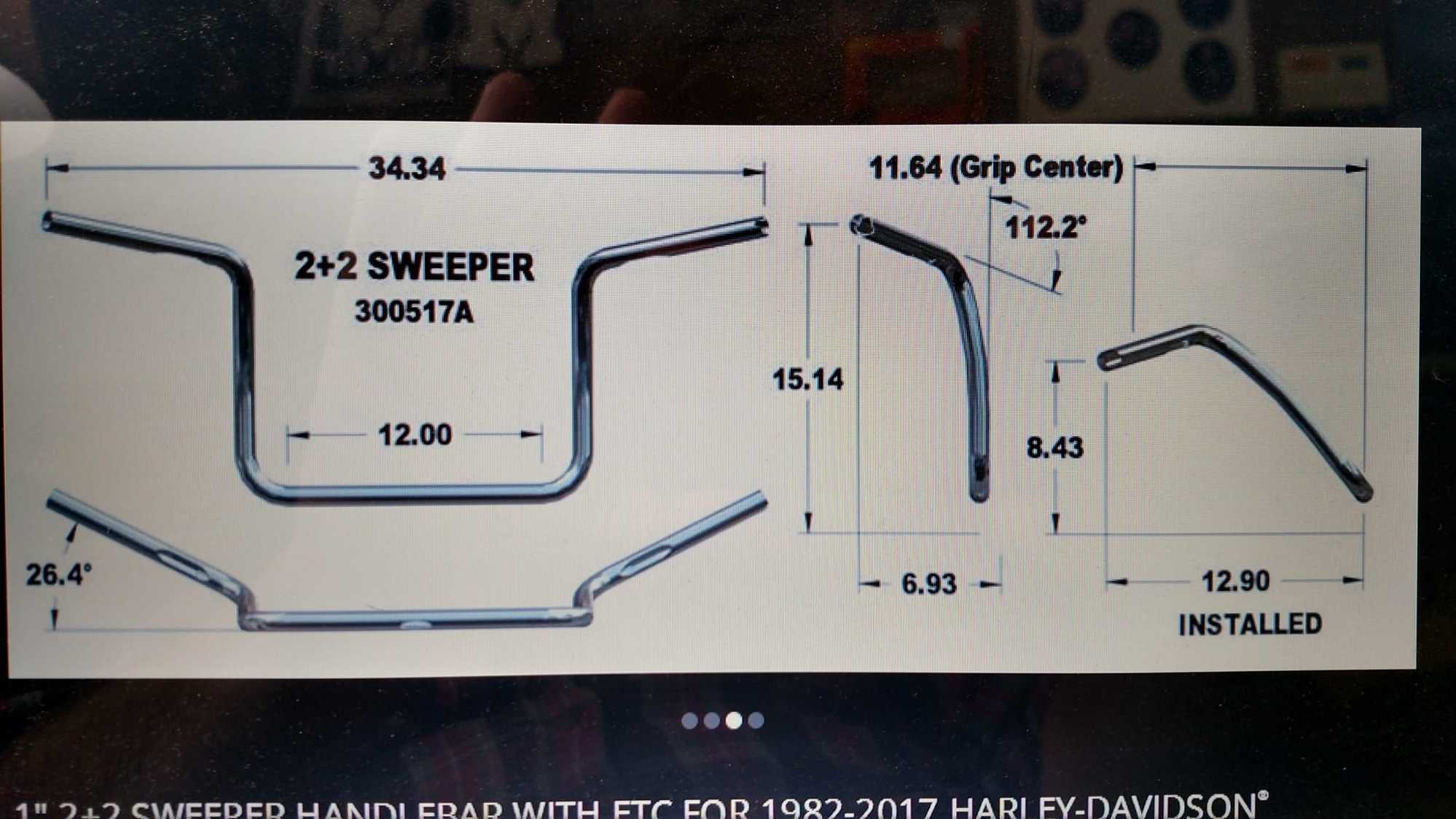

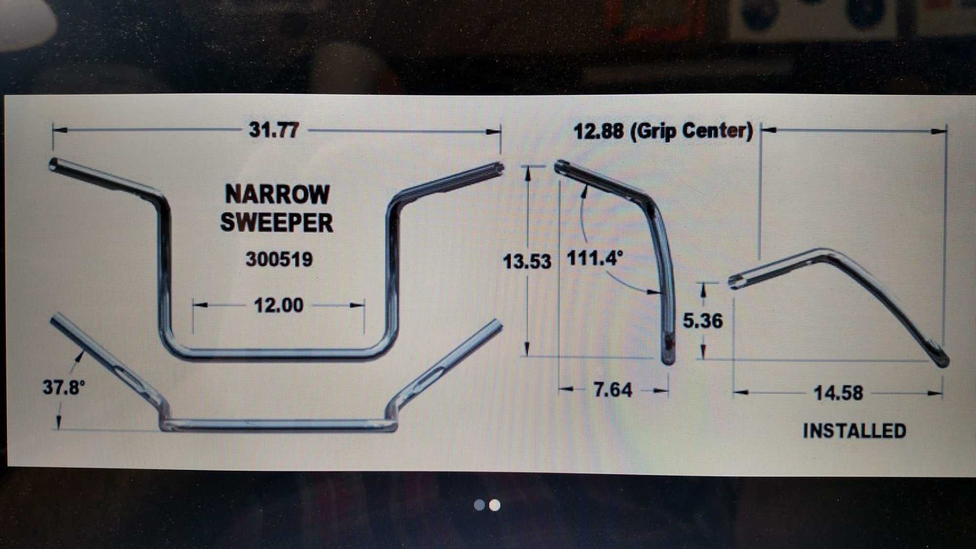

What are the difference between the 517, 518 narrow and the 519? Which would be the best fit for me 5' 8" Medium size in jackets and 15 x 33 dress shirt? Thank you.
Originally Posted by OldMike
I like these better than the Harley ones, a little bit more reach, better wrist angle, easy install, no extensions needed, around $100.
Go for chrome instead of black and you're in!
Khrome Werks 2+2 narrow sweepers

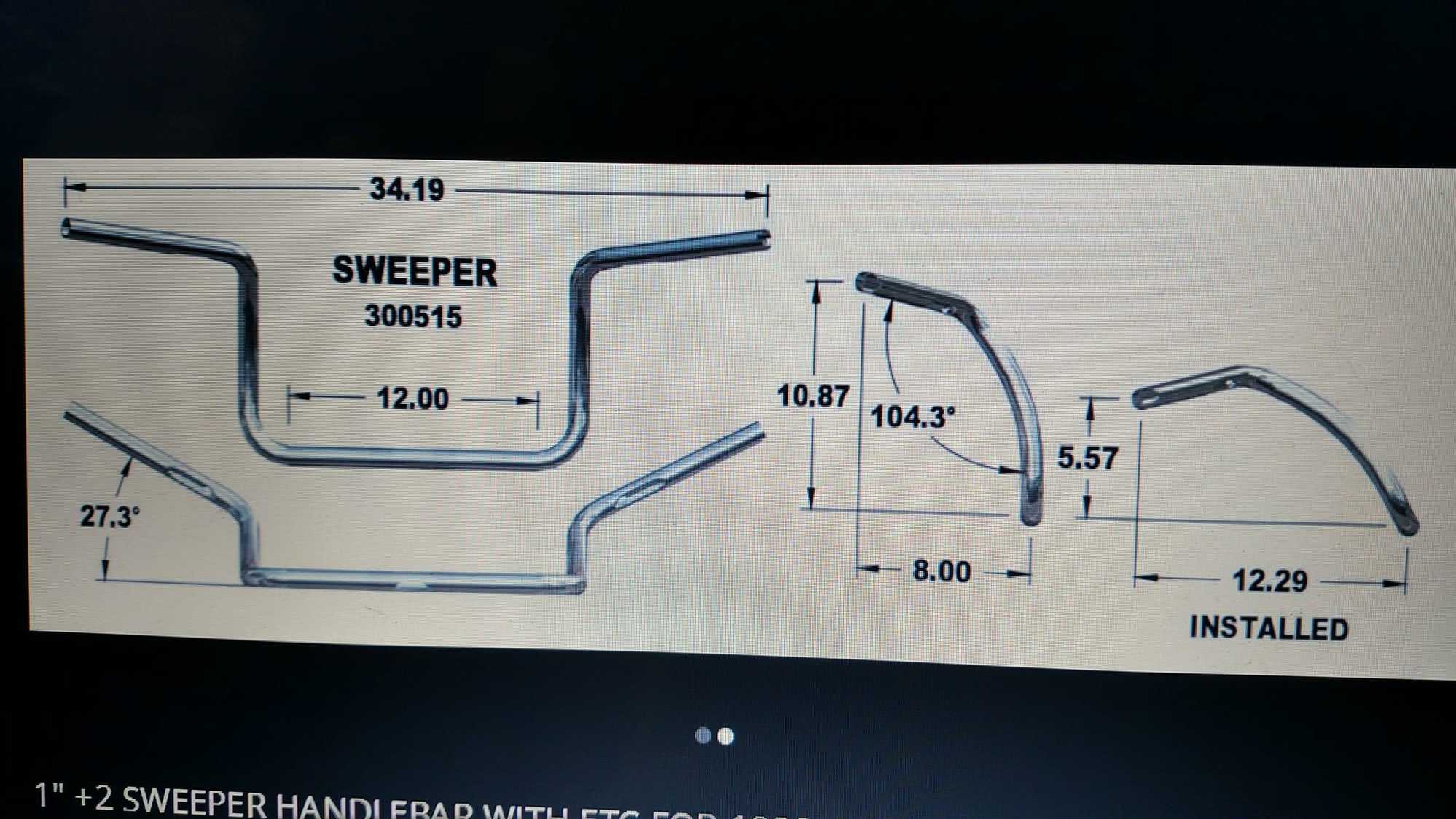

Here's a couple...
