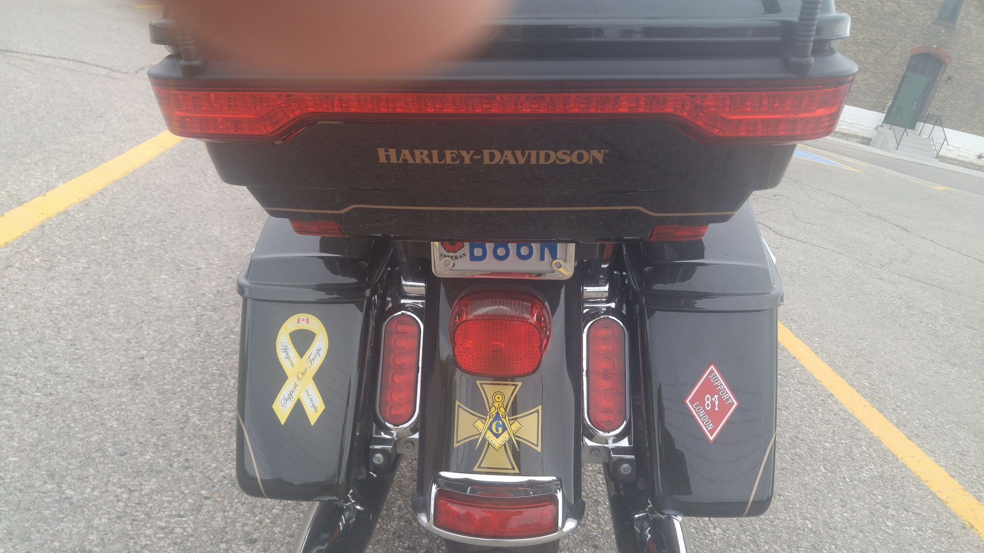

Why pay 200 dollars. I payed 50 Cdn at our everything store Canadian Tire. Heres a pic and they are brighter than fillers. They are just trailer leds.
Now that's a different idea... they look pretty good

Unique look.....that looks nice. Too late for me but maybe that will save someone else some cash to spend on other items! :-)

Did you have to trim the plastic chrome to have it fit between the fender and the bag and if so how? I was impressed enough with your frugal solution, I hit Cdn.Tire just before closing today and bought the last two. Any tips would be much appreciated. Thanks.
