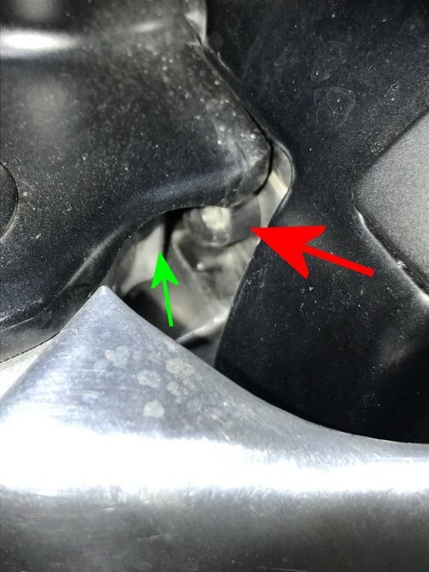

Did you check the clutch inter-lock switch to see if its releasing all the way? By you having to have the clam shells off to switch out the light packs it might have affected it. When the clutch lever is not pulled in, the switch is pressed down by part of the clutch lever. When you pull the clutch lever in, the switch is released and should pop out all the way... this tells the bike you pulled in the clutch lever. If it is stuck in, not extending out, the bike does not know you pulled the clutch lever in. If it started this right after you pulled the clam shells off to change out switch packs it is possible it did not get aligned correctly and is snagging on the housing. Here's a picture of it, in case I'm not making sense. The clutch lever is pulled in. The green arrow is pointing to the part of the clutch lever that will push the switch down, when I release the lever. The red arrow is pointing at the switch, which is out all the way because the clutch lever is pulled in all the way. If you have already eliminated this as a possibility, disregard lol If you check it and its not releasing all the way, try what Punjabi HD suggested above to free it up. I think it is possible that cruise control could/would release when you pulled in the clutch lever for other reasons. This is easy to see, and to fix, if it is just stuck... and easy to clear as a possible culprit. Coincidental timing if it happened at same time as changing the switch packs.
