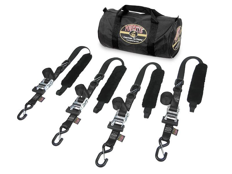

What type of straps are these, do you have a link to where I could purchase these straps?
Thanks

BikeMaster makes similar straps, use them every day and I trust them completely.
http://www.motorcycle-superstore.com...-hook-tiedowns

Powertye
http://powertye.com/store/index.php
Mine are the Powertye - 1˝" FAT STRAP Deluxe Ratchet w/Sheepskin Soft-tye
They also make a 2" version.

The 1-1/2" ratcheting soft tie downs CHECK CHECK!
