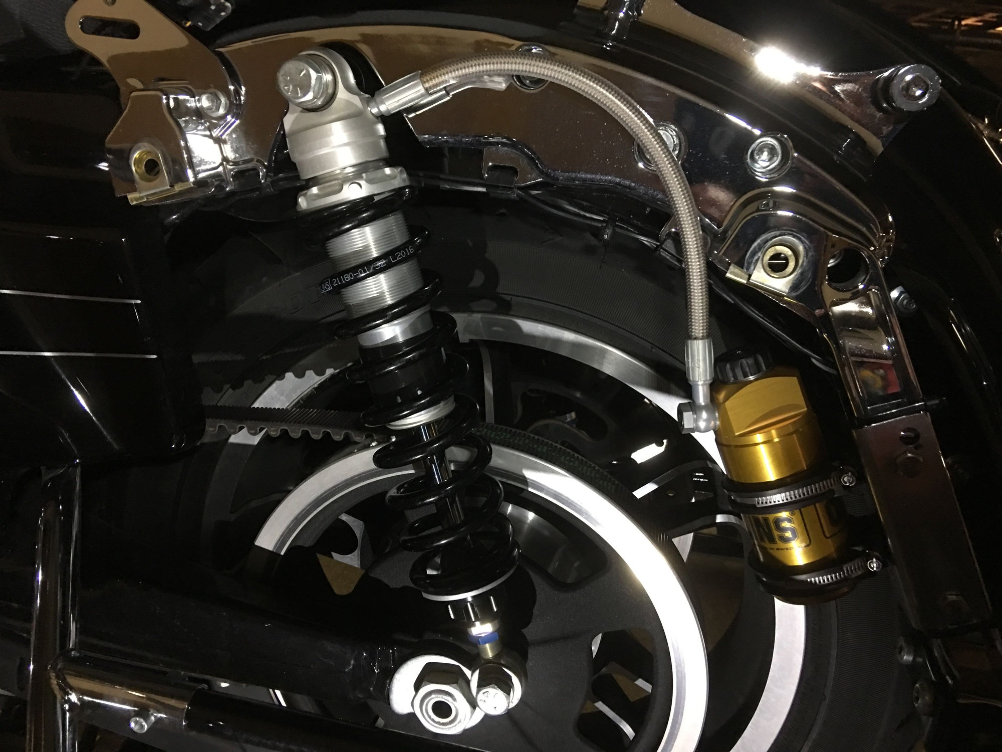

Received my new HD357's from Howard at MotorcycleMetal yesterday and went immediately to work installing them. Not quite the two bolt job as my previous shocks. The remote reservoir requires a bit of customizing of a bracket to mount it to the saddlebag supports. It's a stainless steel angle bracket that none of my damn drill bits would make a dent in, even with my $70 Amazon drill press. Eventually I gave up and made a 9pm ride (on my Dyna) to Home Depot for a new set of hardened steel bits.
Well, its clear how bad my bits were cause the new bits went right through. Needed 4 1/4" holes to line up with the existing holes in the support, and for the reservoir standoffs. Once I was done drilling, the bracket went on easy and I was done.
Amazingly the spring rate was spot-on, needing no preload to get to the target 30% mounted sag. The tie-wrap measurement of total travel is also exactly where it needed to be. Never had such an easy time setting up a shock.
I'm sure once the springs break in I may need to add a little preload, but that's to be expected.
Results: A huge upgrade over the already excellent STX36's I had on originally. I'm not one to get too descriptive, but it just felt great on a two hour mixed road ride today. Love them. Howard did a great job setting them up perfectly, out of the box. Once I get 500 or so miles on them i'll start messing around with the compression and rebound adjustments, maybe.

Is the same set up on the other side of the bike?
No I left the stock shock on the right side. Saved me $600.
OF COURSE it’s the same (but opposite). Sorry, couldn’t resist the opportunity to be an ***...
On my 16 RGS only the left shock as an adjustment on it....none on the right side....go figure!
Yeah, the stock shocks have the preload adjuster on one side. As you said, go figure. I still have my OEM “premium” shocks in my closet.

Looks nice
What is the advantage to the extra reservoir?
