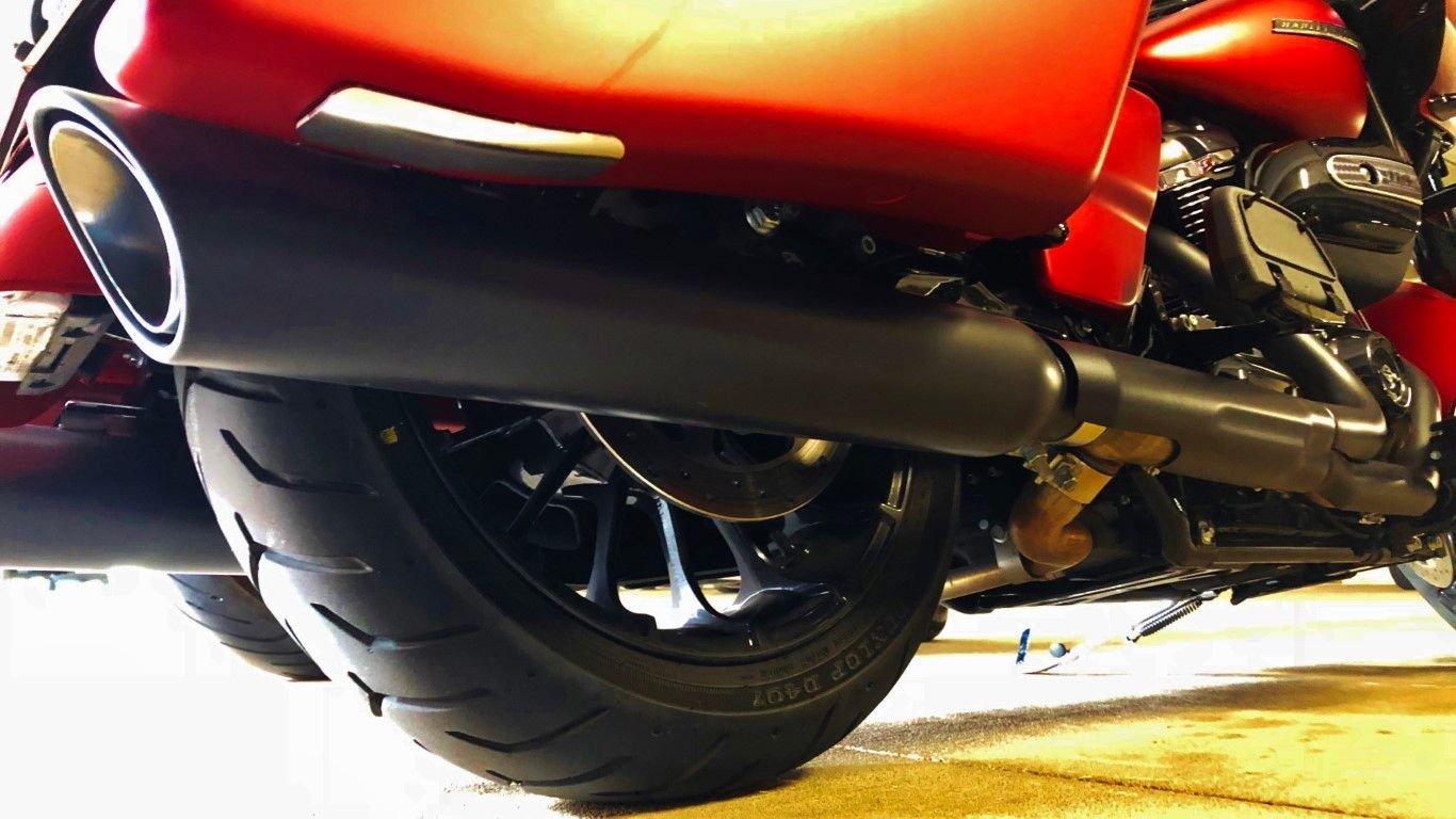

So just answering the original question about slip-on mufflers that match the stock heat shield. Not discussing any possible warranty issues...
I swapped out the OE mufflers for Cobra 909's in black. I liked the price, and the lifetime warranty, and the rolled end looks (at least to me) better. The black matches the OE heat shields. Other options from Cobra require tuning, tuning was not required/recommended for these. They didn't induce any popping, so seems to be good.
https://cobrausa-vtwin.com/baggersre..._black/6108RB/
