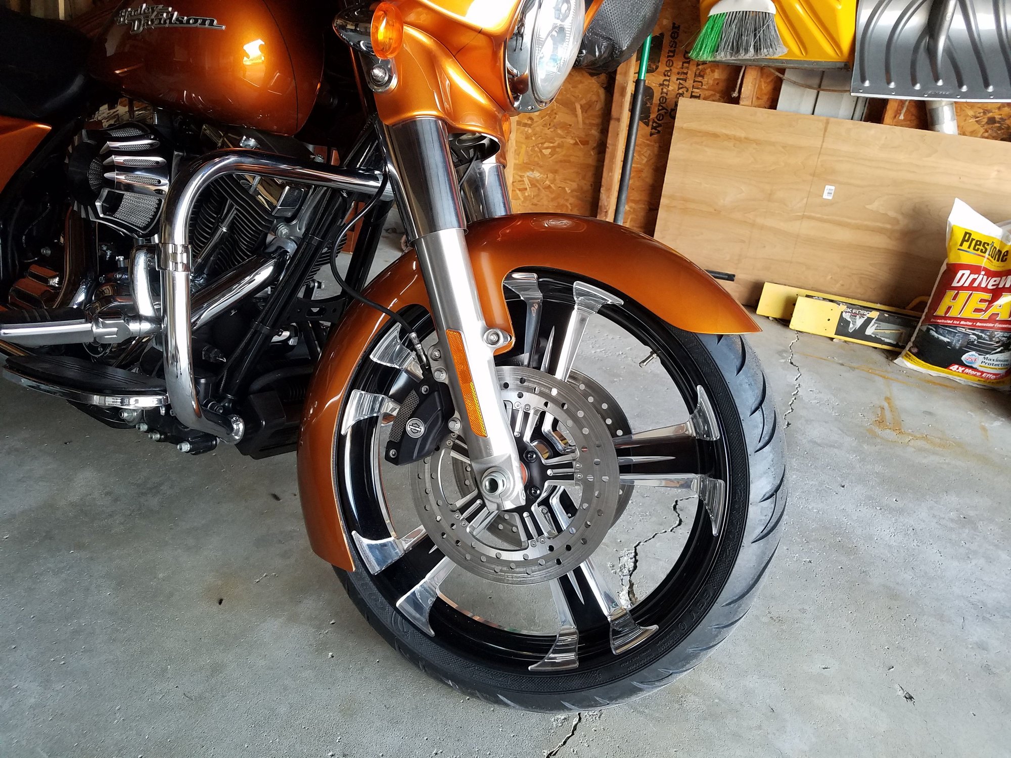

Here is a 21" on my 2014 sgs, nothing needed except a fender extension mount. My current extension came with the bad dad front fender. But before that, hogpro where I bought the 21 from, included a extension for the stock fender which I had on there till recently.

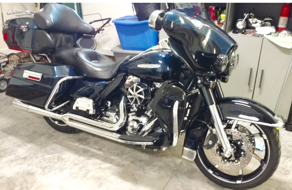

The above picture is the 19” on my ‘12 FLHTK. I also had the matching 18” on the rear. No modifications to the front fender or suspension. One note to think about. On the highway the 17” stock set up is more forgiving than the 19” on a rough rode, pot holes etc. I think this is due to a taller side wall on the 17”. Overall handeling on the 19” was good, I used the HD tires and had this set up for 20k+ miles.
