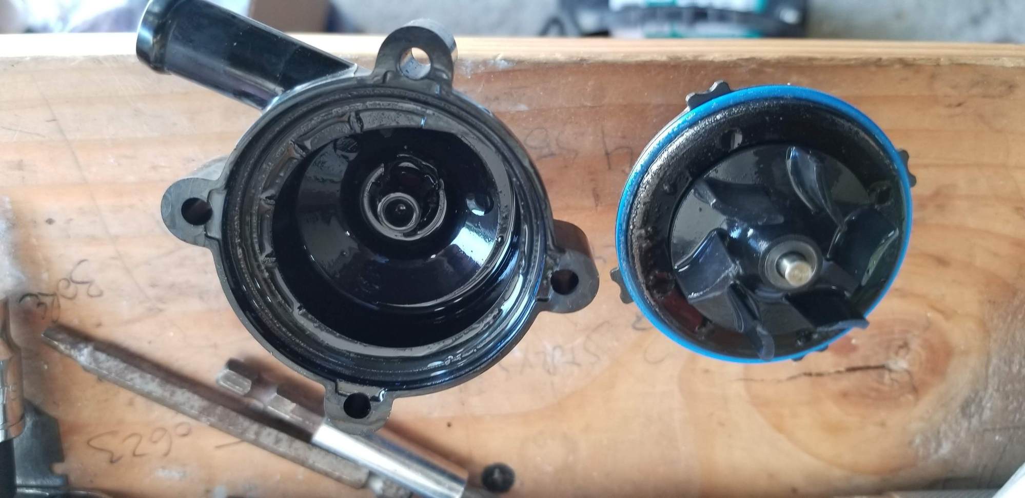

Update!
Put new M8 kit into my ride. All looking 100%...
Took apart existing pump,
Here is what I found...
Pump just taken apart, with burr visible top left case, just above center of pump
Its hard to see, and didnt notice untill I wiped fluid out with my finger. The burr may have been causing the intermittent problems.
Im not sure how much force the impeller has on start, but cant imagine this doing any good ever...
burr found in pump, just next to torx bit..
Than, I remove the cover off the back...

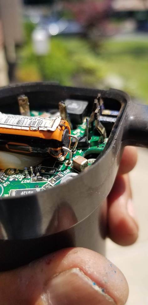

contact separation on factory terminal
You can clearly see just above my pointer finger the factory terminal, POS crimp connection is wide the hell open.
5 years and 27,000 miles is bs. this is something that shouldnt happen at any point in the pumps life.
Im gonna write the MOCO a pissed off letter. I want my M8 upgrade pump comped!!!
While this is really the only thing that has happened in that time, and I love my limited, I understand crap happens on any production line.
Thing is, they must know something went wrong on the production line and shouldnt have. We should not have to shell out more of anything
to cover this

That terminal has been the Achilles heel of every pump failure that has been posted on this forum.

The point is someone is paying to replace a substandard component that had issues from the very beginning and that shouldn't have had this issue in the first place. The proof is that H-D switched to a completely different part manufactured by a different company. They knew the part was a problem and they knew it would continue to be a problem.
