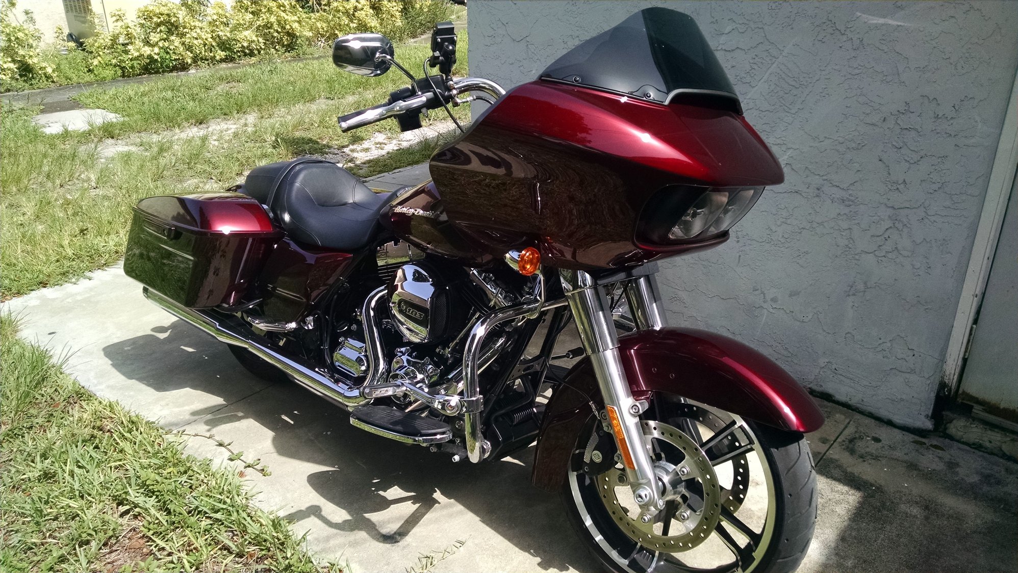

The day I bought it.

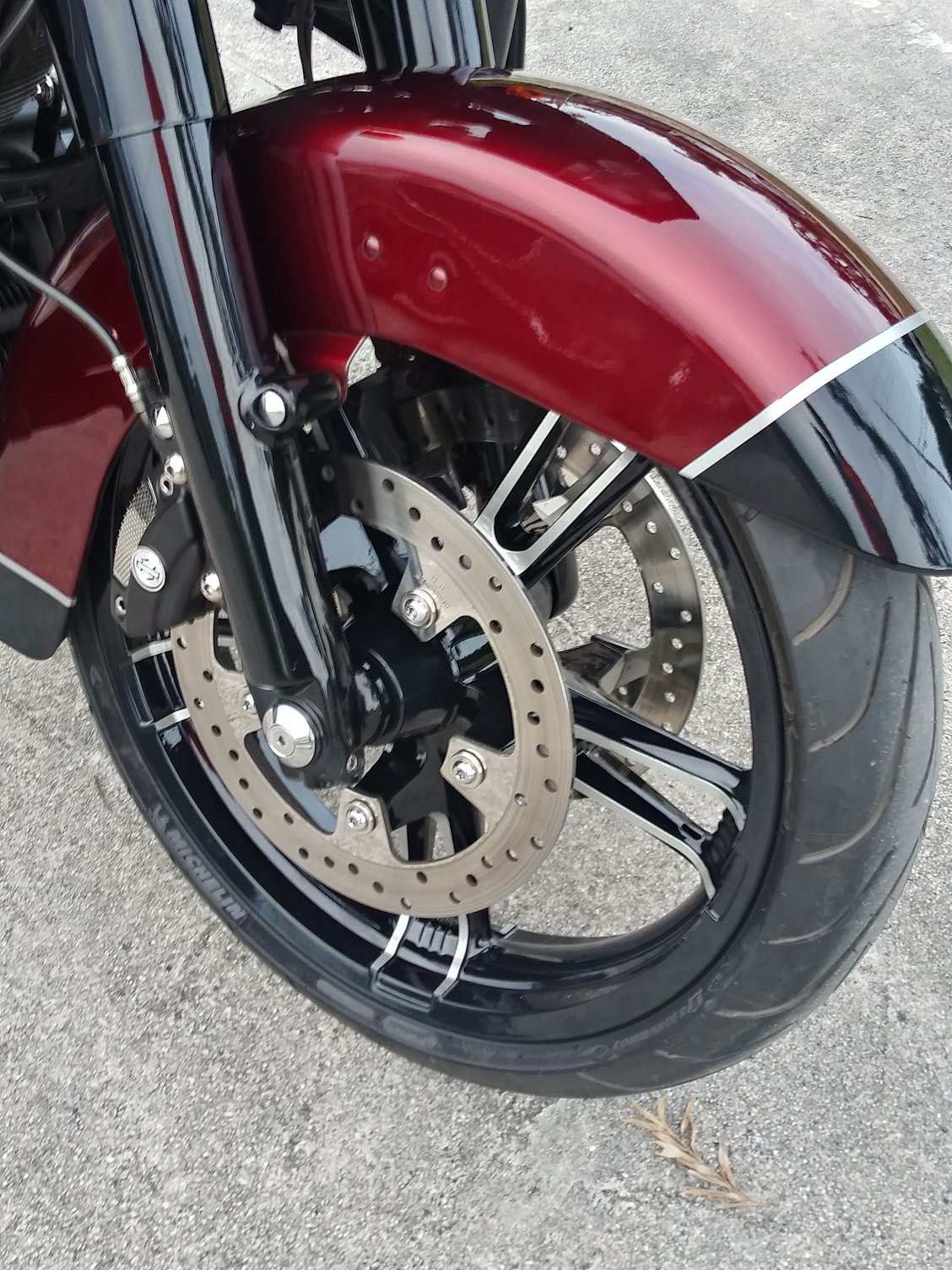

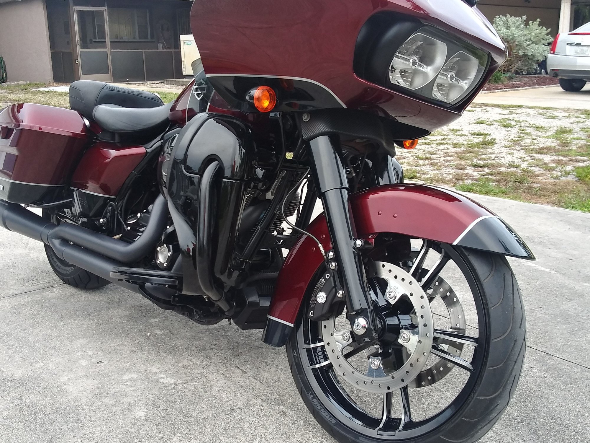

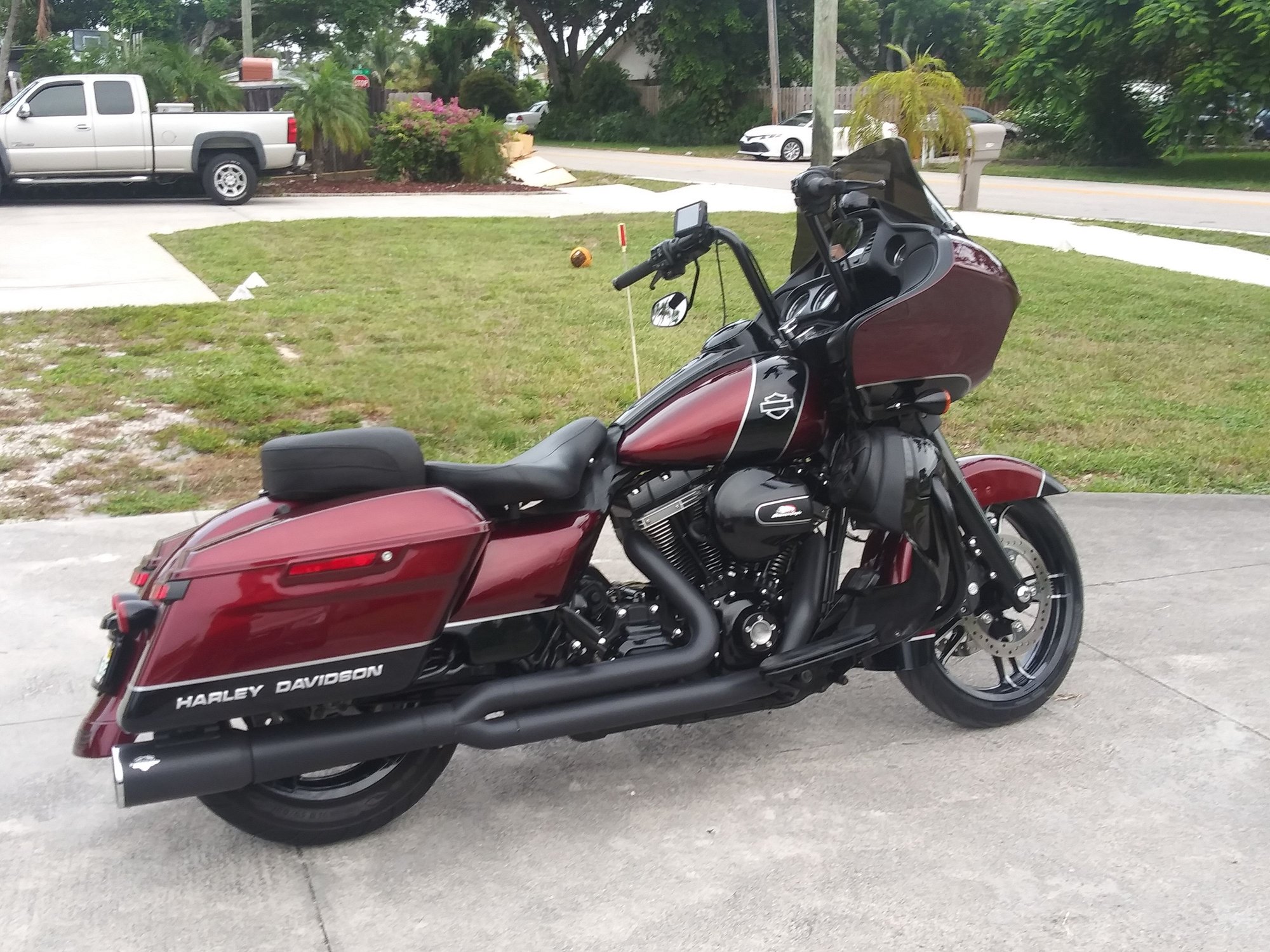

Just finished the bike today. I've had this for almost 4 years now. Decided to make some changes a while back, but life gets in the way sometimes. Had all the chrome powder coated along with the wheel. Also upgraded the engine too. Shout out to Kirby at VeeTwin Racing for the engine kit. It;s now a 107 @ 10.5 to 1 with 110 heads, 58mm HPI T/B, Tman 625cams.
Power Vision with Target Tune, V&H Propipe. Bike was pretty plain Jane when I got it.

Can you tell us about the seat and what that filler piece is in front of the seat to the tank? Also, do you think the air cleaner restricts airflow to the T/B? Feel free to share any other details of the modifications, too. Thanks!

The seat is a Cop seat. I removed the air spring and modified the bracket to get it as low as possible, there are two rubber cushions only under there. The filler panel is something I made out of 1/16" ABS plastic, used a heat gun to form it, it covers from the tank back to the rear fender struts. The A/C is a Arlen Ness Big Sucker that Kirby machined the back plate to match the new HPI 58mm. I literally just finished when I took the pictures went a for a 10 mile ride. Taking it easy for the break in period, then off to the dyno for tuning. It sounds incredible wasn't expecting it to be this radical based on some others videos that have the same cam.
