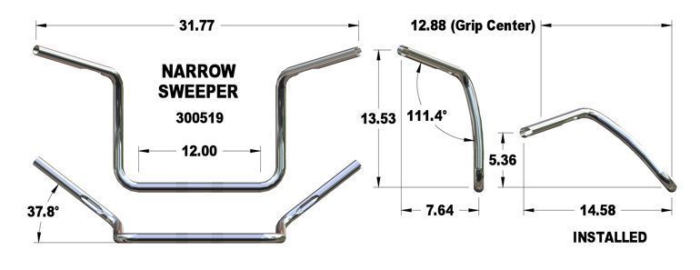

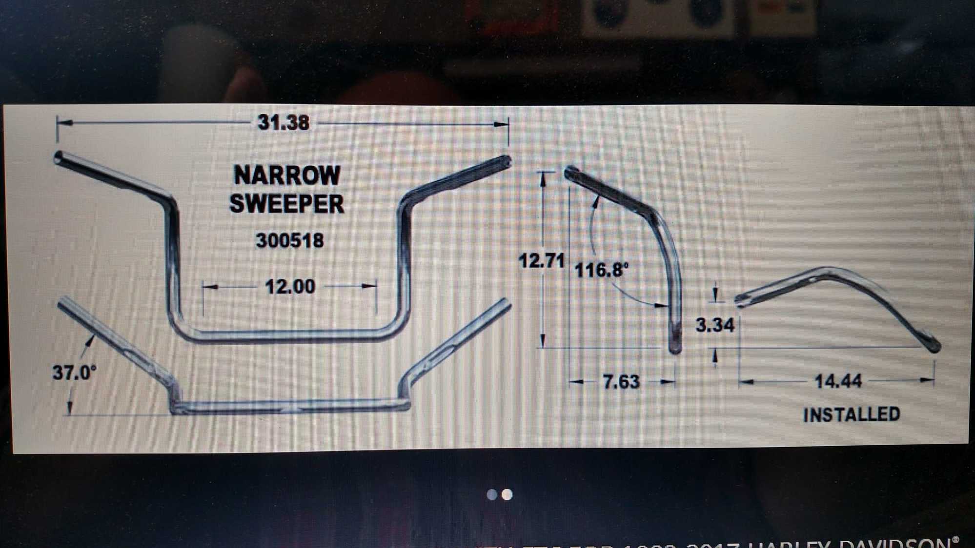

2" up and 2" back are just that from stock, it doesn't really matter about the intended use from the Mothership...its just a dimension from stock. Its really about what fits you. These 518's for the 2014-up from Khromewerks are what I picked up for mine, many will recommend the 519's for the 2009-2103's and have said they still fit the newer models. I got them to try because of the same complaint on the wrist angle of the "Reach" bars...hope to install soon...
Old Apr 23, 2020 | 05:37 AM
Tail Rid'r's Avatar
Tail Rid'r
Joined: Nov 2017
Posts: 146
Likes: 23
From: Leatherstocking Country
519's
