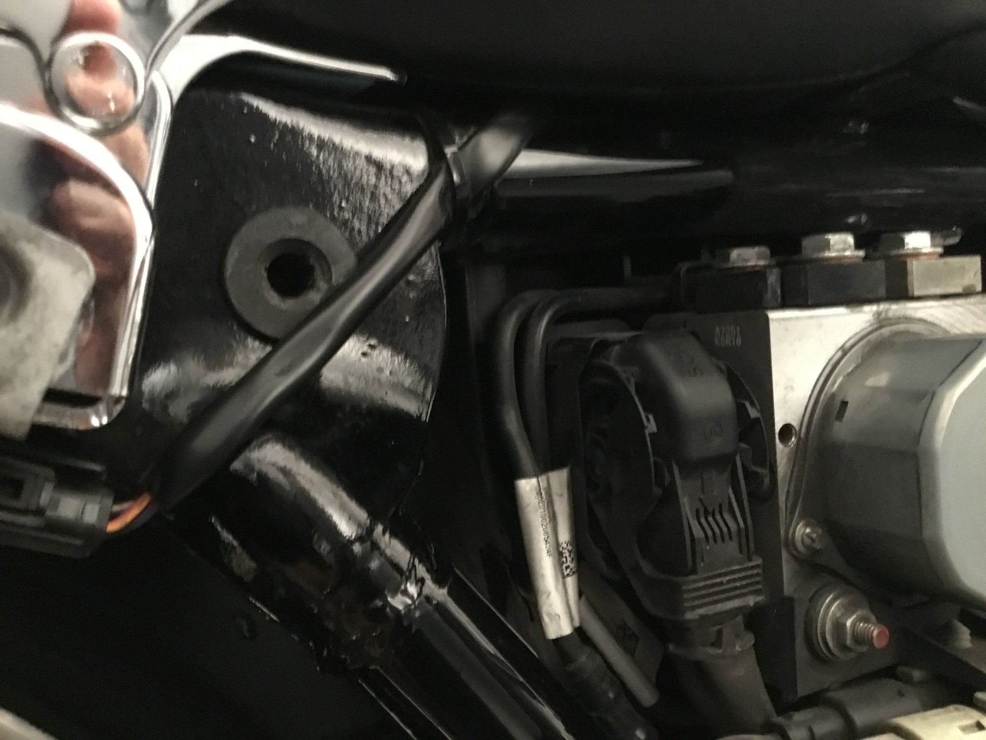

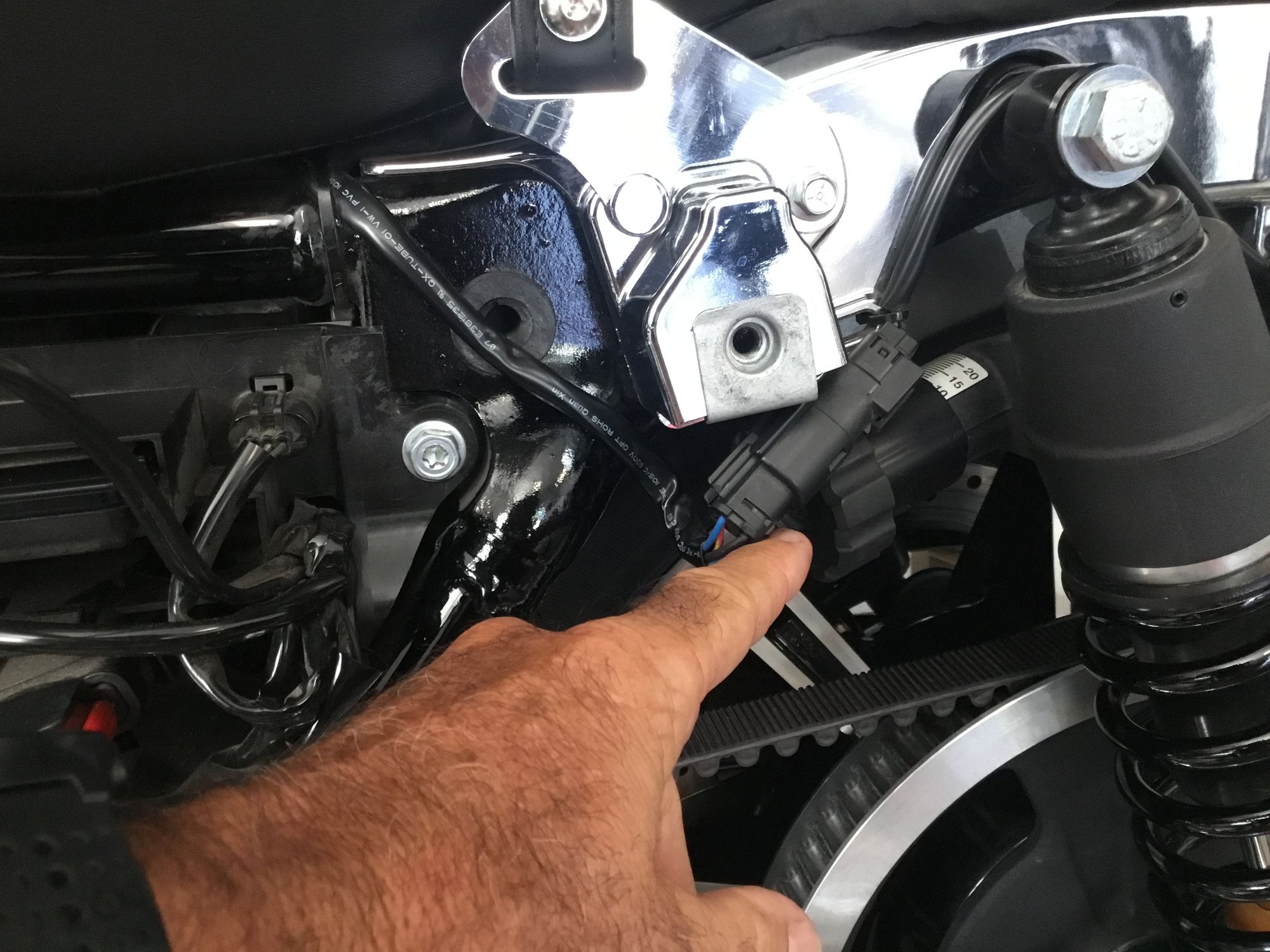

Great pics, very helpful. If by chance you have the seat and side covers off could you take pics of those areas so we can see how they handle the harness in those areas? Thanks

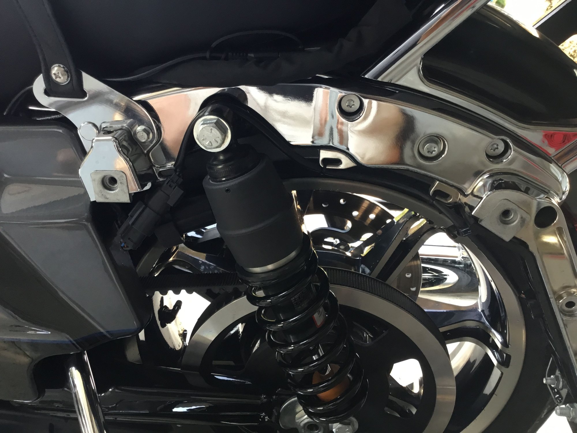

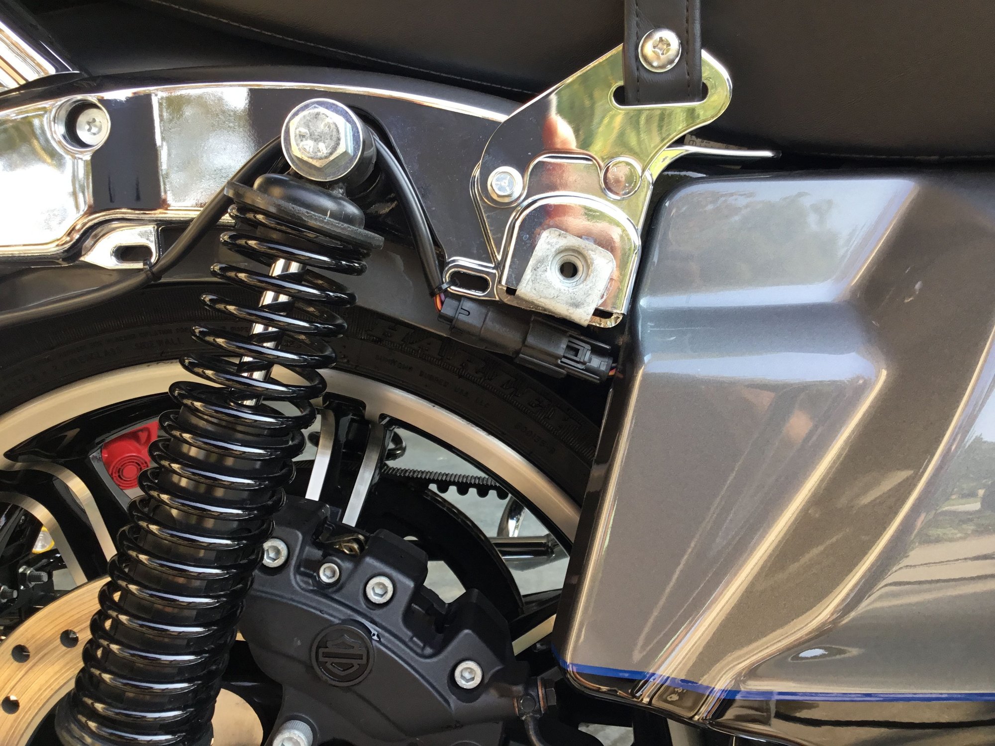

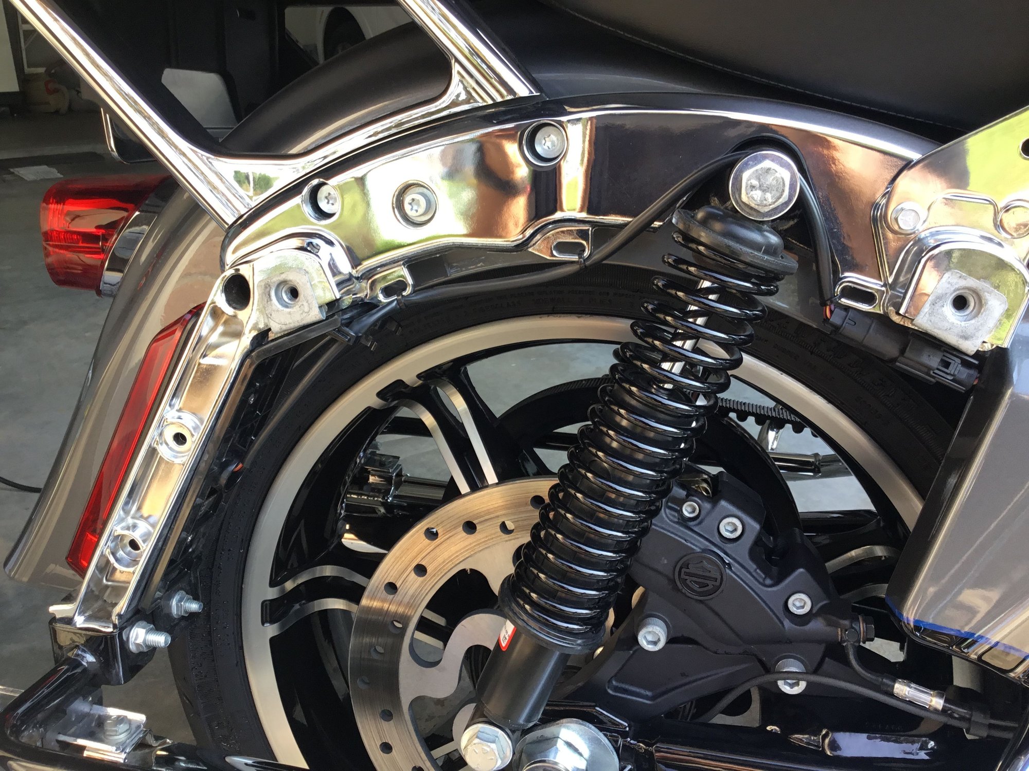

These wires are zip tied to the frame, right under the seat
thanks for taking the time to take the additional pics

You are welcome, they were not the best pictures. Side note: the harness is double zip tied under the seat, to the frame rails.
