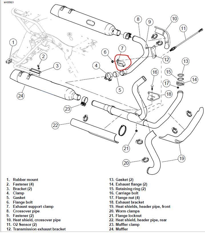

All the clamps involving the left muffler, all the way to the right-hand pipe connection seem tight.
I'm gonna try replacing the rubber bushing under the saddlebag rail.
I was kinda surprised there is no 'gasket' in the cross-over support clamp per the service manual, nor on the bike ........... should there have been one ? (see pic)

Part #7 is only a support clamp, as described. Keeps the crossover pipe sitting still thru all of the vibration and movement.The gasket/clamp set up is with parts #4 & #5.
Yeah, just seems like a gasket would help there, too - seems like a fair amount of play there that could lead to rattling.

If there's still slop between the support clamp and the pipe causing a rattle, what about shimming the diameter of the pipe larger with some thin metal material like layers of a soda/beer can? Or maybe, if it's feasible, clamp a copper penny between the pipe and the clamp? That would shut that sucker up!
I am dealing with a rattle I have been chasing for months and finally confirmed it is that cross over support clamp. Not quite sure what i am going to do to fix it yet. I should know this since I installed the exhaust (years ago) but I am assuming I can loosen that clamp and shimmy something in there without unbolting the left side muffler and muffler clamp, right? I could be missing something.

a cut up soda can would work, maybe even double it up, it will be a temporary fix, but should do it
