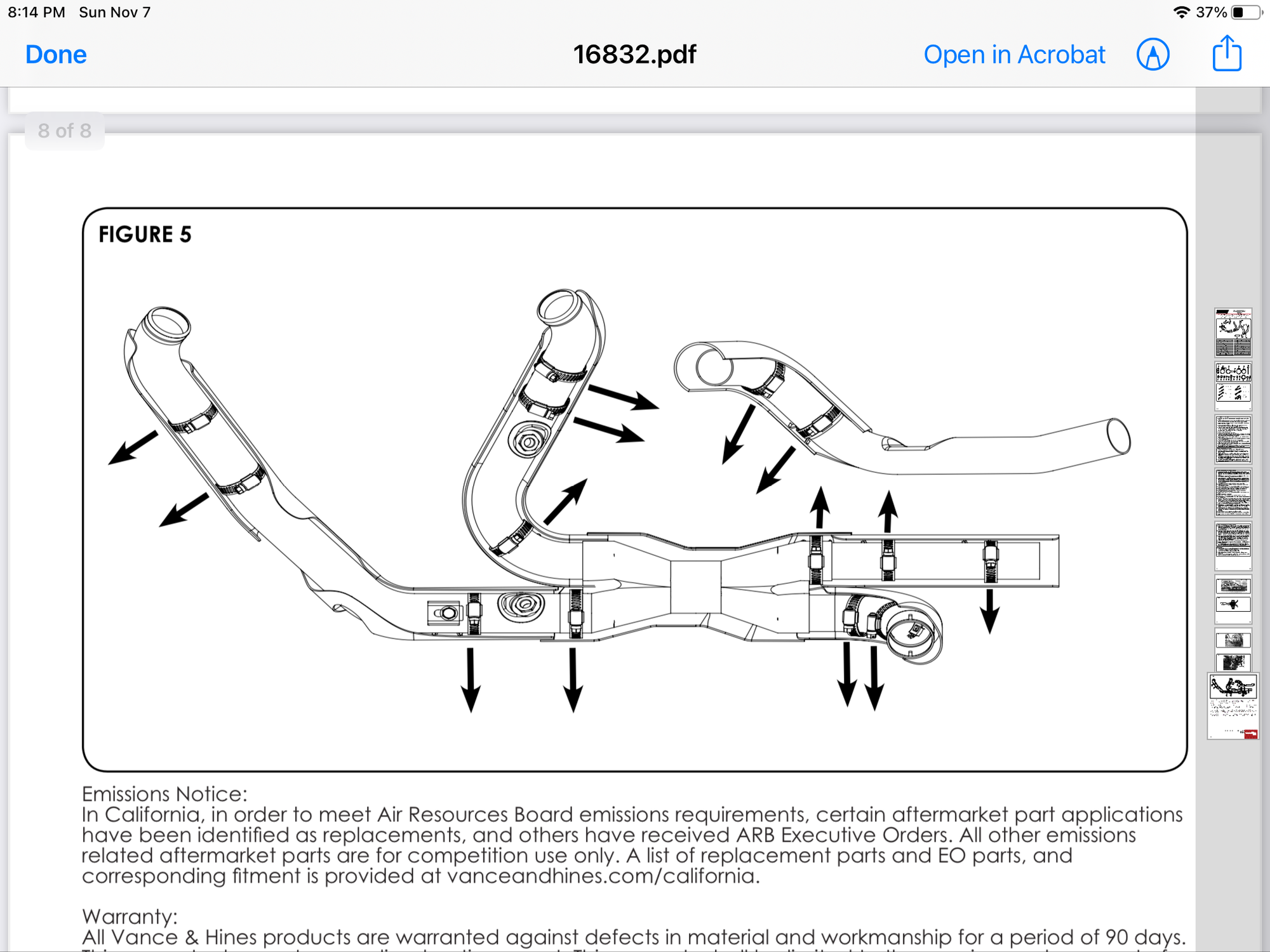

I will send them a pic, and finding out for certain, but this is a screen shot of the install instructions that V &H sent me on these pipes.
Notice the bungs are in the same place as mine. Very odd though, I agree. The ones on my OEM are side by side.

I stand corrected..... Forgive my skepticism.... When I read that the pipe had been welded, and saw what I thought were mismatched sensor bung locations, I was worried the pipe may have been "customized"...
If that pic is from the the install instructions, It appears that is how that pipe is designed, and the sensor bung holes are properly placed.....
I am going to save that pic. I've never seen that before, and I am always willing to learn... Obviously, Vance & Hines know a lot more about exhaust design and construction than I ever will...
If those bungs have 12mm x 1.25 threads (as I now suspect they do) you are good to go... !

Vance n Hines confirmed, thru email, this morning, those positions are normal. Said it provides optimal tuning in those positions. So now just need to order the parts I need and get it on there.

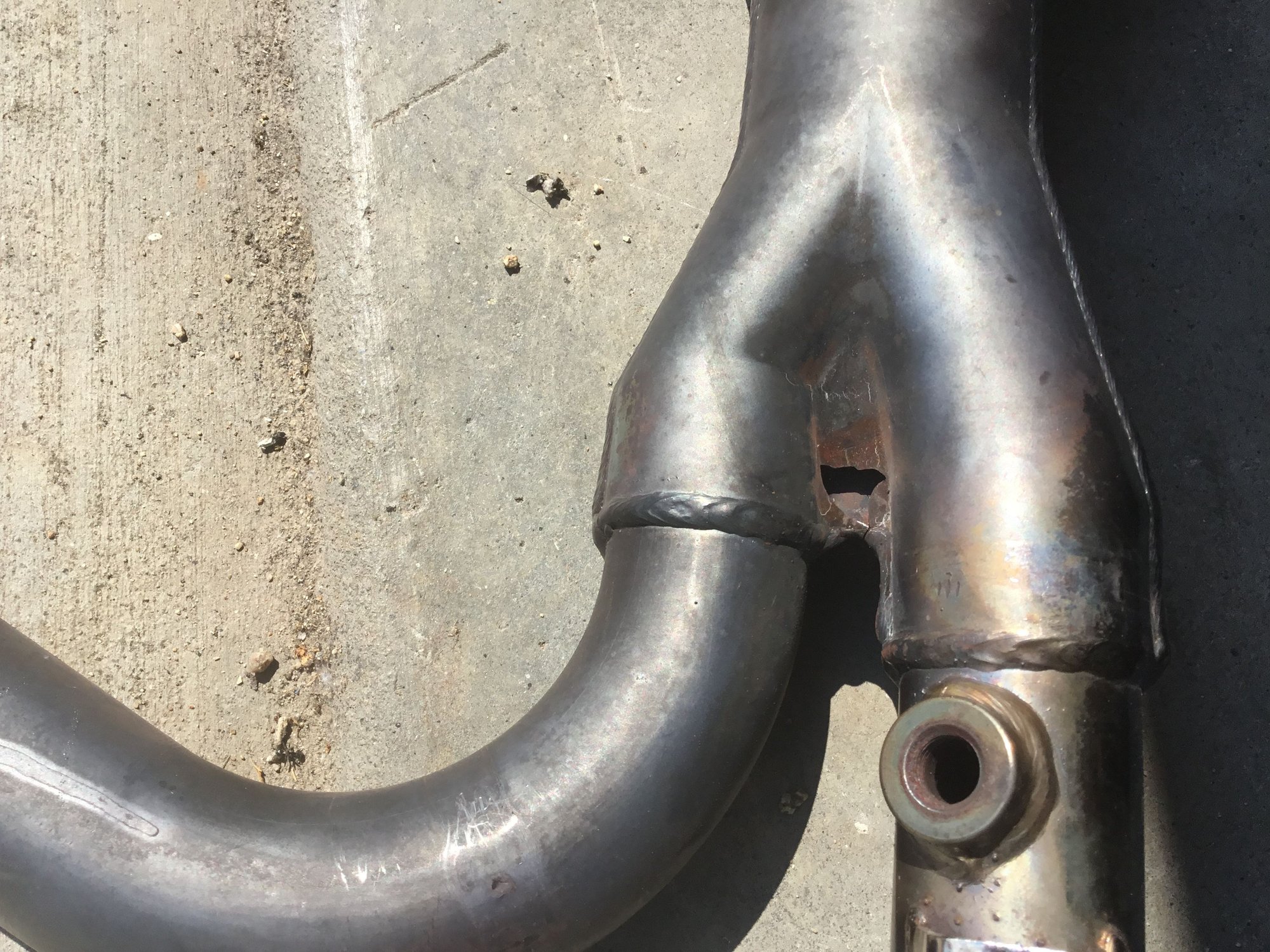

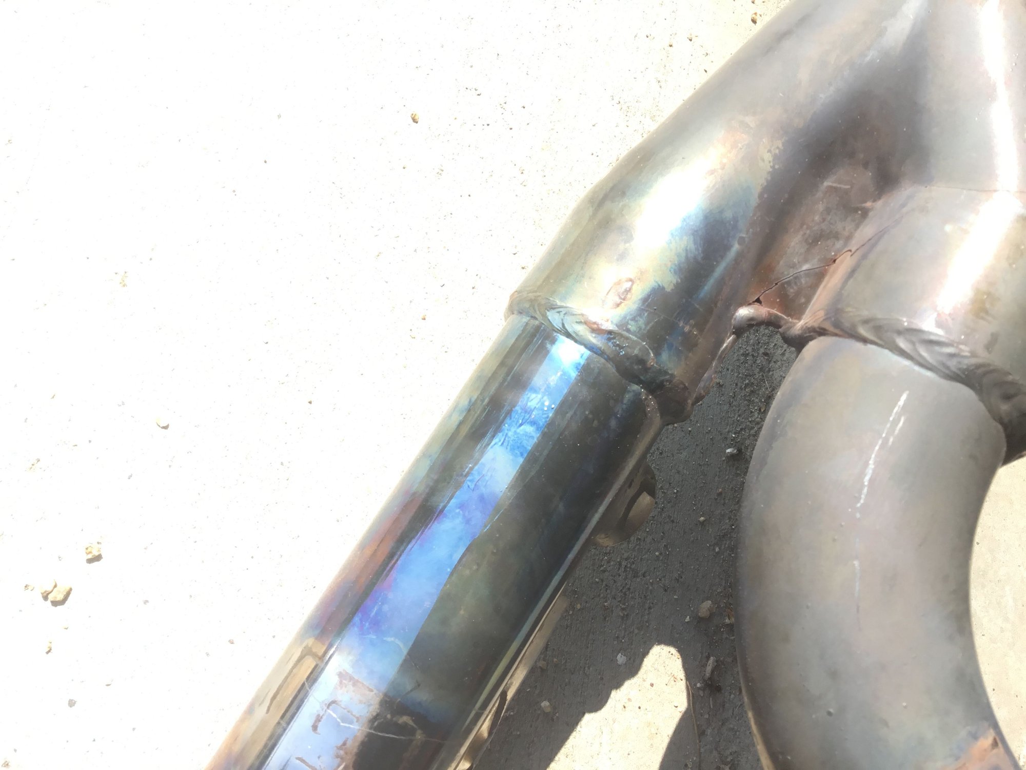

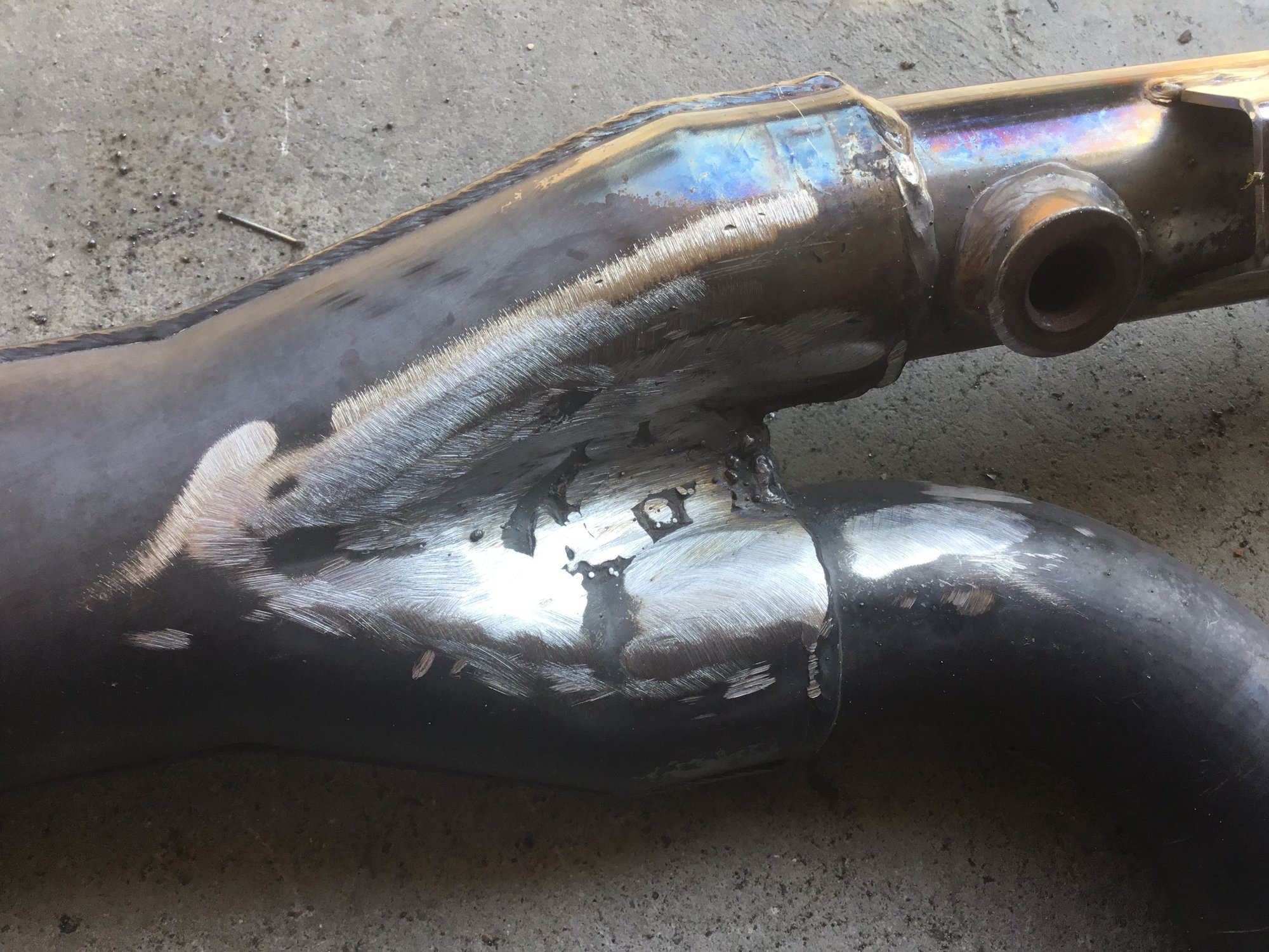

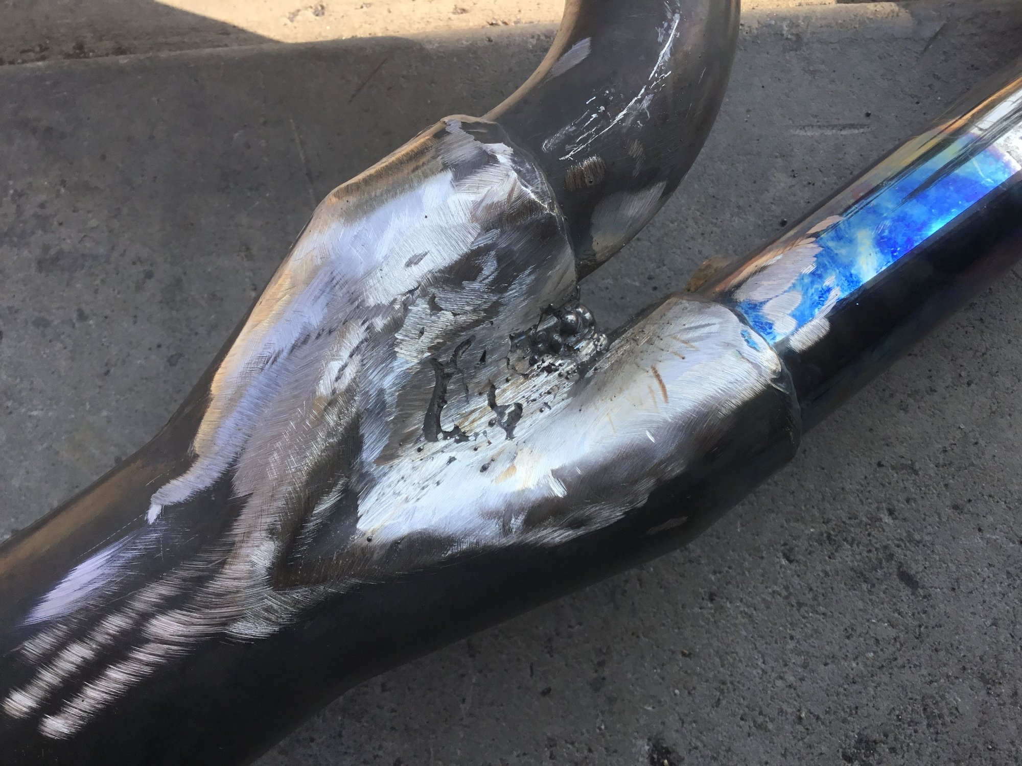

No, it was me that welded, at the weld points, were in the crossover area, that had cracked open. These are the before and after shots. It belonged to my wife's cousin. He and his wife, rode from WA to meet me in MT for the Beartooth Rally, this July. He discovered this on his bike just two weeks before departure date. I tried to get him to have it welded, but he decided to just buy new. So I said, save the old one and I will take it off your hands, when we come up in the RV in August, which we did. Thats how I got the header, and shields, but no brackets.
