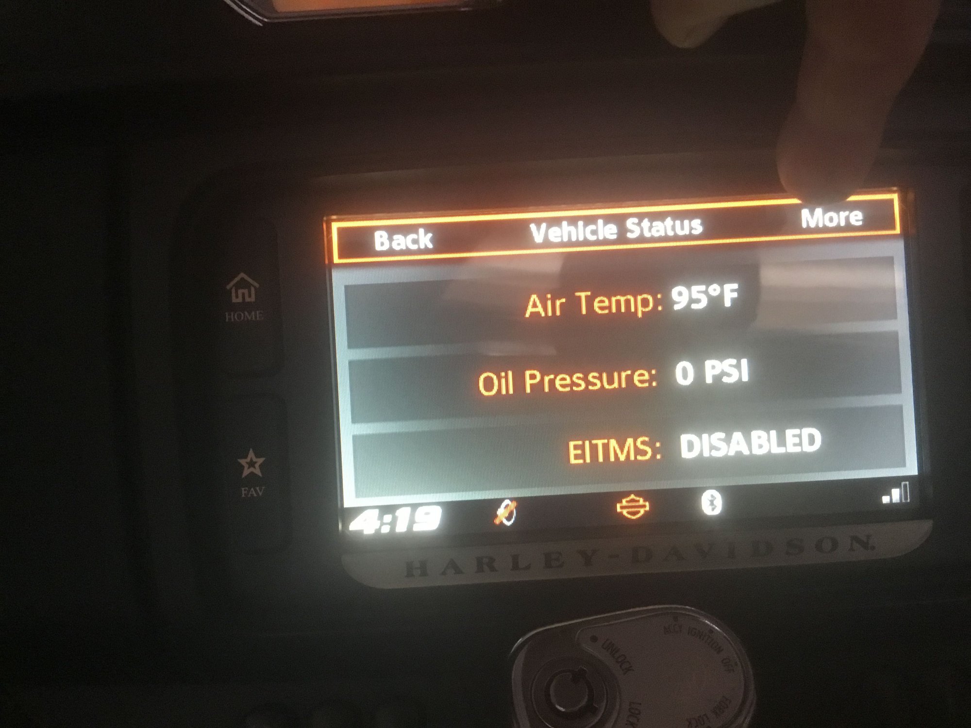

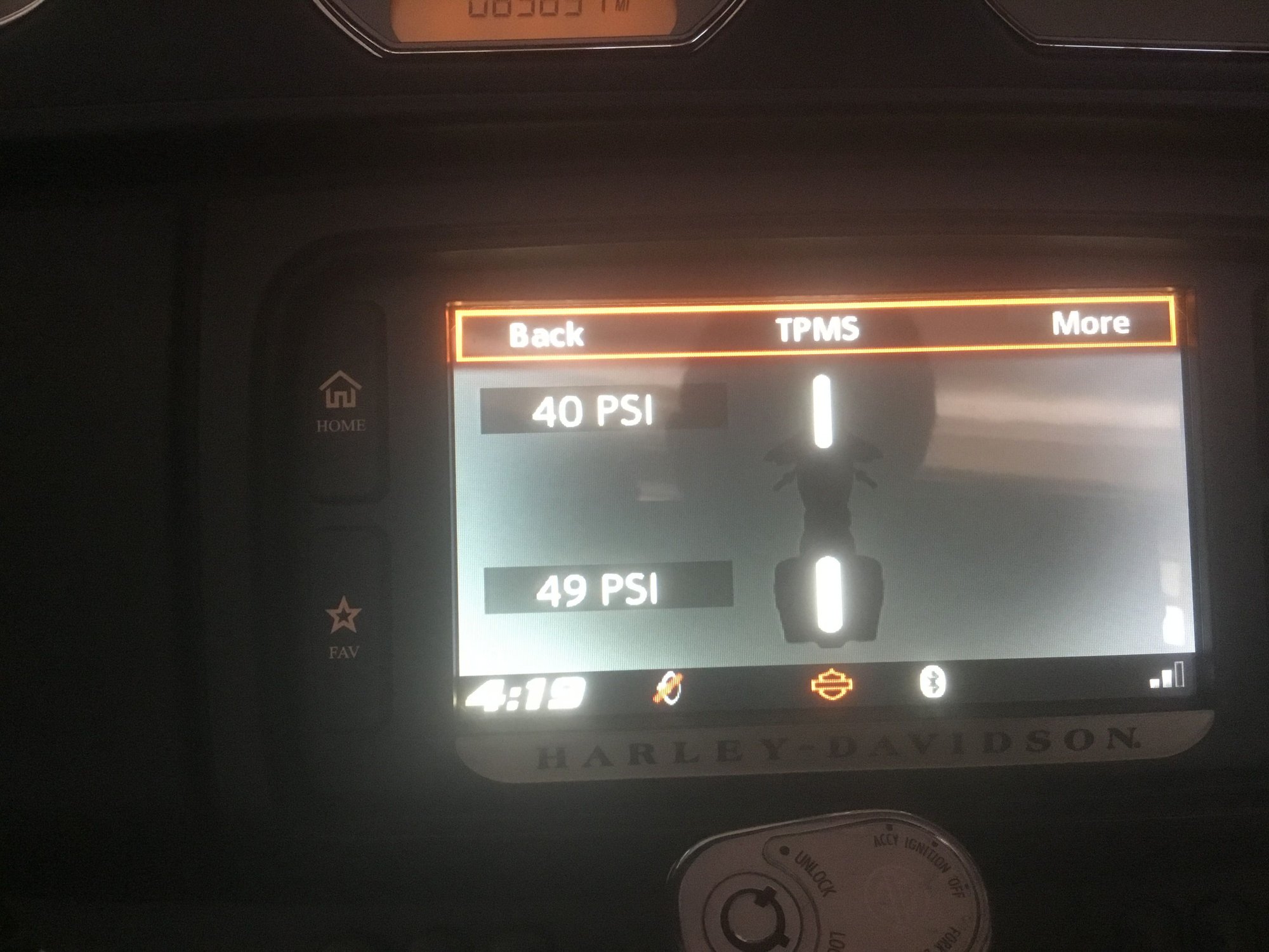

Originally Posted by handirifle
Ok Ssitruc (Curtis) pm'd me and I called him. As I suspected, it was already in there, just did not know where to look. So I took a couple pics to show everyone where and what it looks like. The top pic if from pressing the info button (front part of right turn signal switch) and in the upper right hand corner (where my finger is pointing) the word "more" is lit. Not sure if it was before this upgrade. Press the "more" button and the second pic is the TPMS display screen.
Special thanks to Curtis and all the others that gathered the info necessary for these upgrades.

Originally Posted by d_slat
I am gathering what I need to add TPMS to my 17 street glide this winter, but I haven't found an online source for these "bushings" yet. Does anyone have a link they can share? if not, one of these day's i'll have to prioritize it and try calling FOBO.
Edit: I think the smaller ones from this kit may work, but im going to have to take the tpms sensors to napa to find out
https://www.napaonline.com/en/p/NTH90431
https://www.ebay.com/itm/131558552133
This is what I used. You only use the "T" shaped bushing provided. I got this set because I used the other two 90* on rims on a trailer that uses deep quad tires.
edit: your link would probably work as well.

Originally Posted by Sandwiz
I did not know the 6.5Gt system was capable of doing this BUT, I am glad I did not, because..
The first screen shot of the "Info screen" is where I keep my at for going down the road.
This way I can see the Oil Pressure (and my oil temp gauge) and my Phone is on the Tire Pressure via the FOBO Bike 2 system.
ya I like to know what is going on at all times :-)
Yea the GT display will display it, but that function can only be turned on with the later model of BCM. You could still install the TPMS, and just toggle back and forth when so desired. I usually only look at mine when I start a ride. If I suspect my tires might be a tad low, I check with my 12v compressor before getting on the bike. That's only if it sat for a couple weeks.
