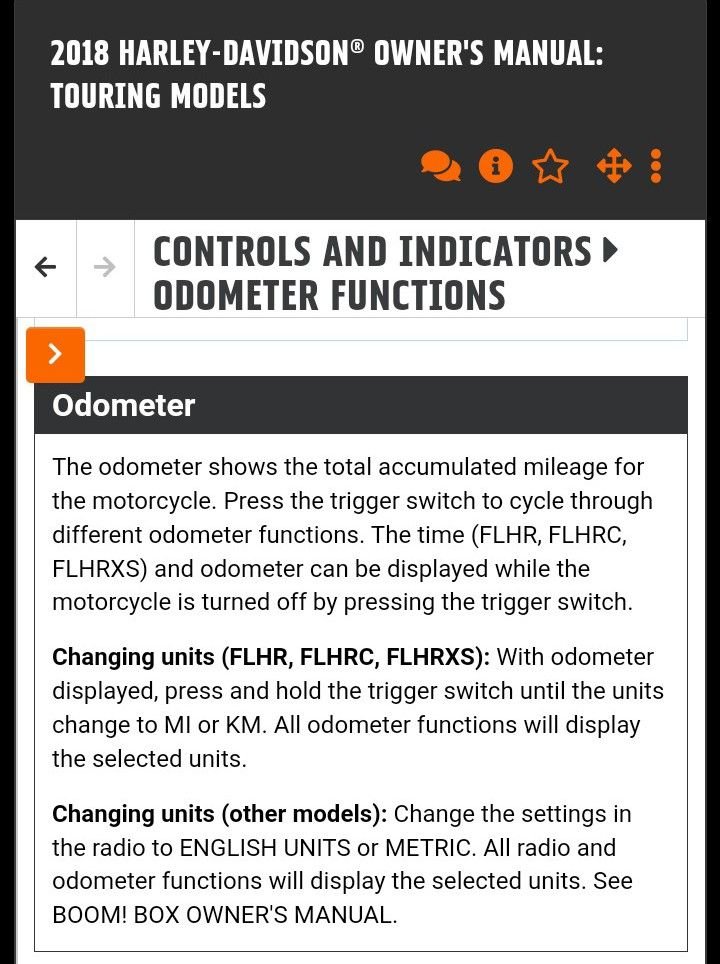

Hi
Street Glide Special 2018
After installed HDHU.14si audio i have the odomoter in miles instead in Kilometers?
how can i change?
Thanks

Press and hold the top button on your left grip, the one that cycles trip trip A, B and miles to empty. It has to be on the odometer screen when you do it.
I believe that procedure only applies to models without a radio. On my 2018 SGS the odometer units are changed via the settings in the radio.
The OP installed an aftermarket radio. Is the aftermarket radio capable of changing the settings to "ENGLISH UNITS or METRIC"? I don't know.

Correct, i already try to press the button but nothing, the solution is the other model screenshot, i have HDHU.14si audio system, i ask to supplier the fix because also i set the radio in KM on the odometer don't change
