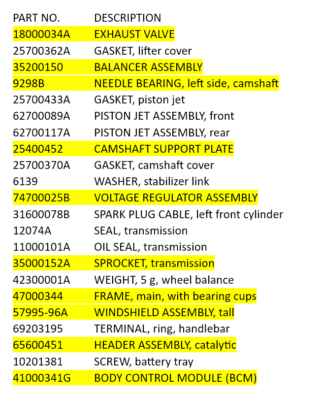

On the H-D Service Information Portal you can find parts lists for bikes. The lists identify all the new parts each model year.
I looked at what changed on a Police Road King from '22 to '23 when I bought a '23. I've highlighted the more interesting changes.
H-D updates a lot of parts that you don't see just looking at a bike. I'm sure most of these parts were updated on the '23 Roadglide too.
