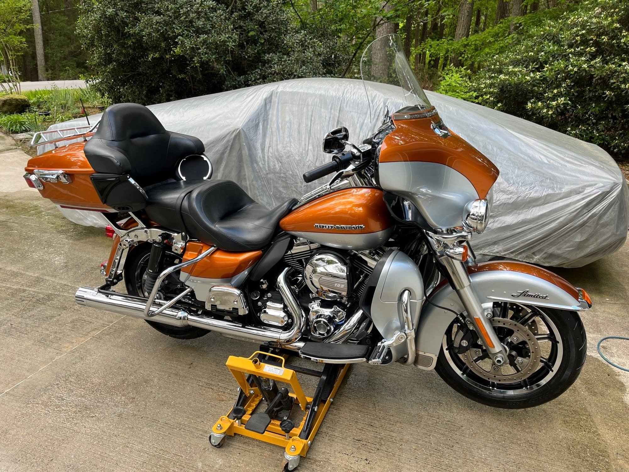

I've used this 1500 pound Harbor Freight jack for 15+ years without incident. All 3 of my bikes have been on it many times. I don't normally strap the bike down unless it will be on the jack for a long time. A few things I do: Don't raise the bike any more than necessary. Make sure the mechanical lock is engaged so weight is not on hydraulic cylinder. If working on one end of the bike ie rear tire change, I will support under the front tire, keeps the bike more stable. Make 100% sure your kickstand is fully forward prior to lowering the bike. It would really suck to safely lower your bike back to earth and then tip over because kickstand was not locked in.
