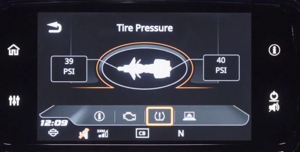

Just to clear up any confusion that -might- exist.. The FOBO isn't compatible with the Harley TPMS which is part of the RDRS option. https://www.bluegrassharleydavidson....r-systems-rdrs . The FOBO sensors won't talk to the Harley TPMS system.
The images shown in this thread are Apple Carplay images, which are mirrors of what's on an iPhone. Without Carplay set up on your GTS, you won't see the pressures. (The image below is what the Factory TPMS screen looks like on a GTS) . But if you have Carplay it's a great way to check the pressures without having to look at the phone. (One of those things that make CarPlay 'worth it').
FWIW, on my last bike I ran the FOBO system for two years, 12,000 miles on rubber valve stems with no problems.
FOBO provides a slick Apple Watch app. You can read your pressures on your watch and if a tire goes down when riding, if you have the haptic feature turned on, it will 'buzz' your watch to let you know.
FOBO does track you. You must allow FOBO to access your phone's GPS and you have to be connected to the internet for it to work. FOBO beams your position data back to the mothership. (Other apps do this as well. Waze, Google Maps etc)..
Factory TPMS screen that comes with the RDRS option:
