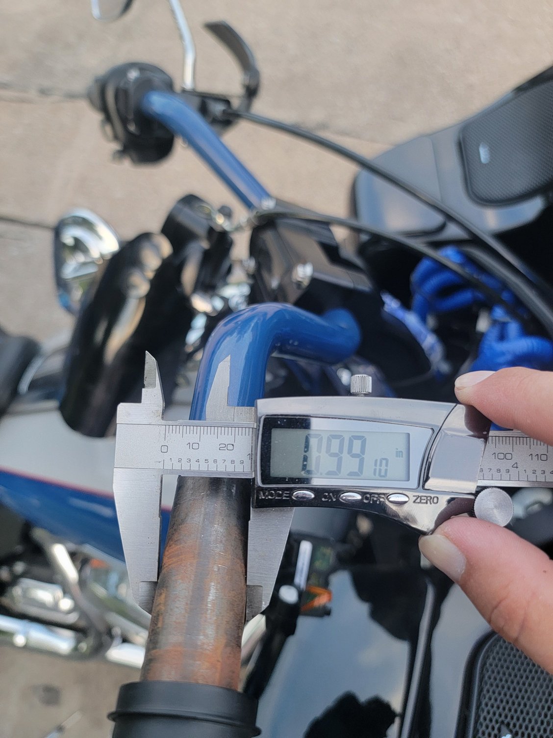

I did a full Tbar swap and the bars are 1" in diameter and my throttle side switch housing won't tighten down anymore and it's loose. I have a temp solution with a couple layers of electrical tape to bridge the gap, but has anyone seen switch housings that are made specifically for 1" bars

I thought that all of them were 1".

Cut up a beer can. Makes for an awesome shim.
