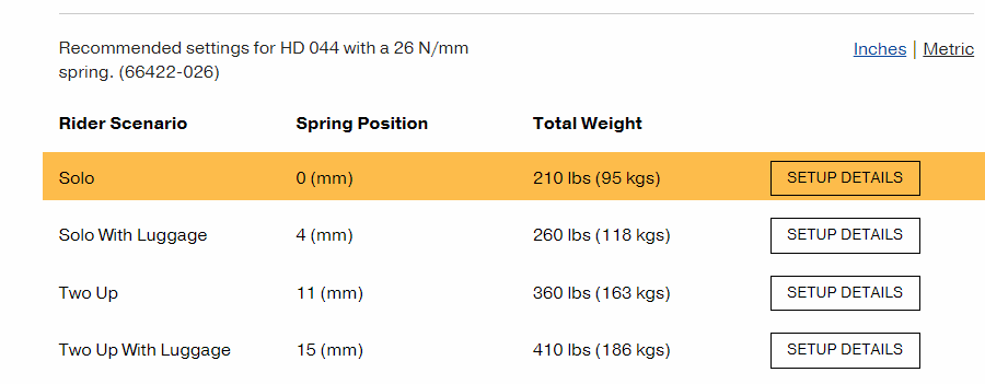

When I had ordered my shocks, I went through Ohlins USA. The gent I spoke with (IIRC, his name was Jerry), basically loaded my weight, passenger weight and assumed luggage loads into their online calculator. Based on that, you can see the recommendations below, and although I use 1mm vs zero for solo, and 8mm vs the recommended 11mm for 2up, these settings are close to ideal.
From the Ohlins USA online spring calculator

Edited to add: Just noticed your bike has a tour pack? I'm guessing that weighs 40-50lbs. Based on the snippet from the Ohlins calcuator above, and if you're 220lbs, 3mm might be a touch light on preload, but in the ball park.
