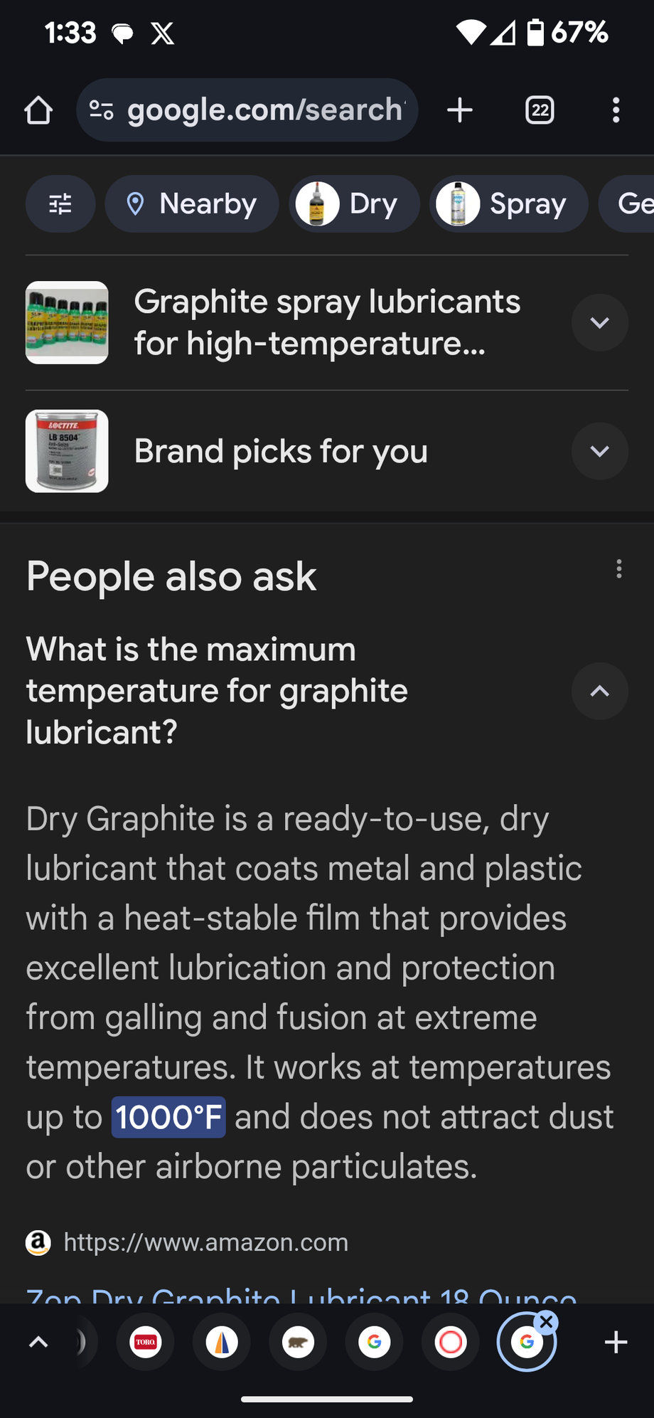

Dry graphite lube will withstand high temperatures. You can get it in a spray.
