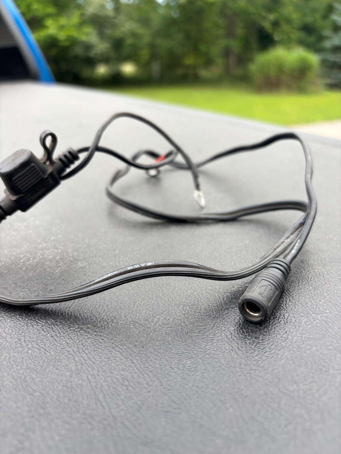

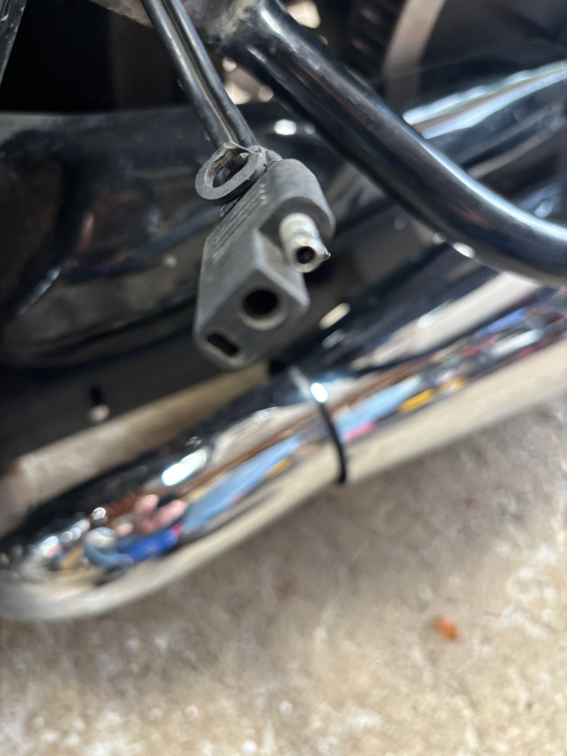

New to me 2014 Street Glide Special. Under the left side cover is supposed to be a factory pigtail for battery tender. The two pigtails I found there are attached. One looks like a battery charger but different, and no clue as to where it is wired in. The 2nd pigtail (round) was connected direct to the battery (removed now). Anyone know what either / both are for? Thanks!

Top-Tender plug
Bottom-Heated gear plug

Top one is a standard battery tender. I’ve been told they have the extra port for European models. Not sure if it’s true, but it will work with a standard battery tender.
second on looks like a boogie lights power, but could be a phone charger.

Bottom is for heated gear.

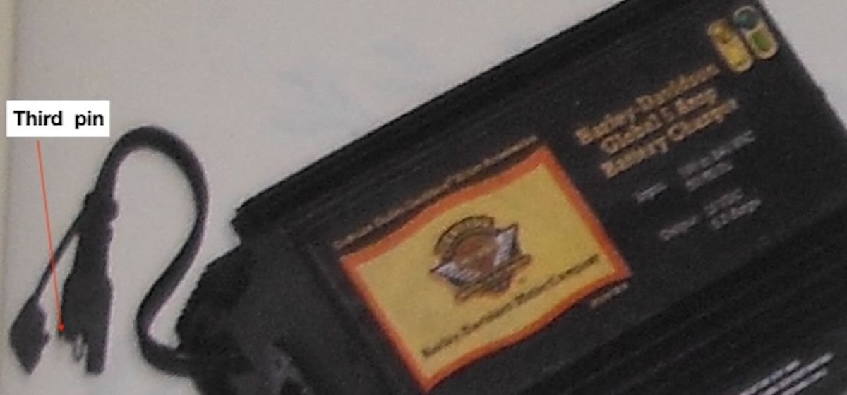

HD offered a "Global" battery charger in 2004. It could charge at 1.25amps or 5amps.
It was compatible with both the HD 2-Pin cable and 3-Pin cable.
It would charge @ 1.25amps with a 2-pin cable and automatically charge at 5amps with the 3-pin cable. The cables were interchangeable with a 2 or 3 pin source.
Here is the Global charger from the 2009 Parts & Accessories Catalog:
Here is a close-up of it's output cable. If you look close, you can see the 2nd positive pin at the end of the arrow. It is a blade, more than a pin.

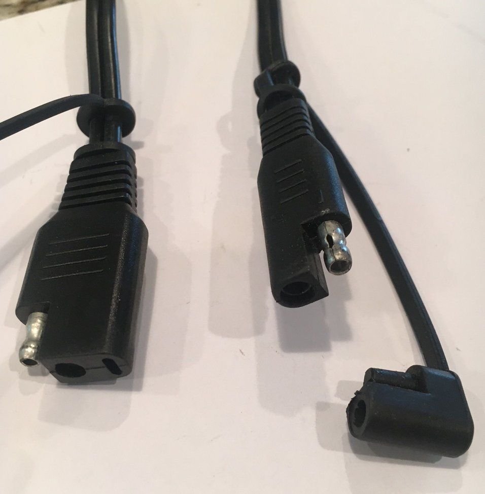

Here are the ends to the 2-pin and 3-pin connectors.
As the ad says, the cables are interchangeable between 3 or 2 pin cables. I believe they only made this charger for about 5 or 6 years.
I forget the year, but HD switched to the ambidextrous 3-pin cable, and never looked back...

The round one is definitely for heated gear. I installed one on the wife's bike and mine.
