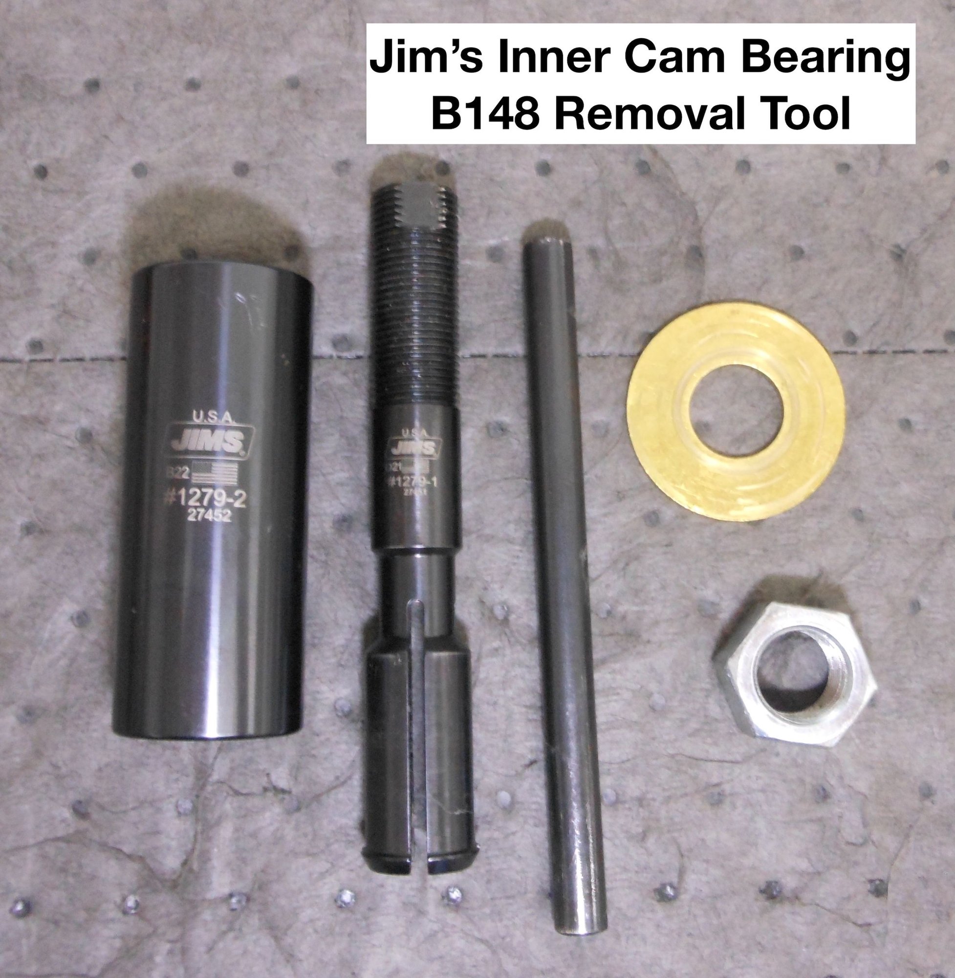

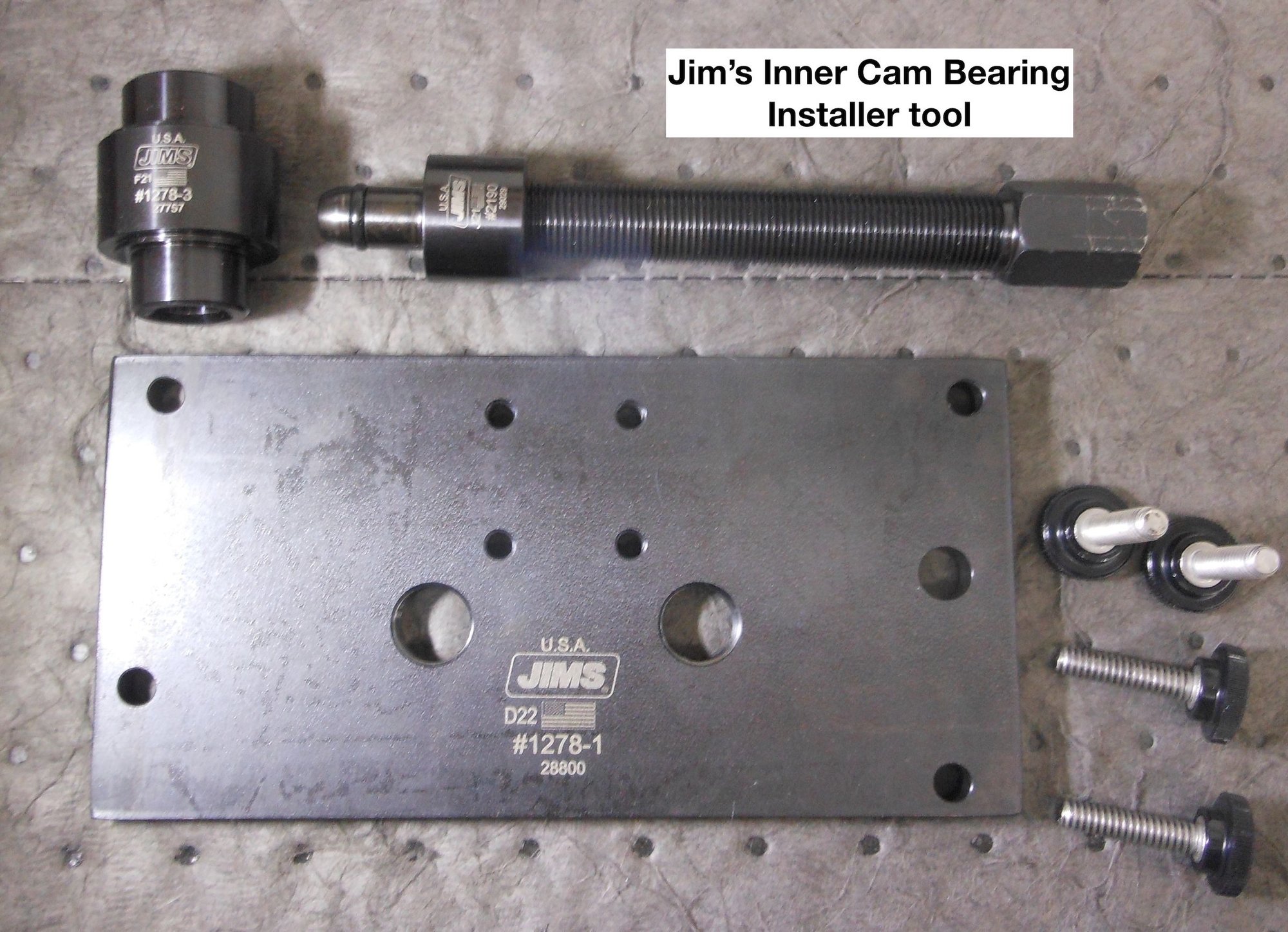

I had a few more cam chests I knew I was going to do work in, and who knows how many others. So I bought the Jim's B148 Inner cam bearing removal tool. I like the fact that it uses a cylinder for the bearing collet to pull against, instead of a plate. I have used it 4 times now. I also bought the Jim's Cam Bearing installer, which just happens to have a double headed bearing pilot that can install both B148 & B168 bearings.

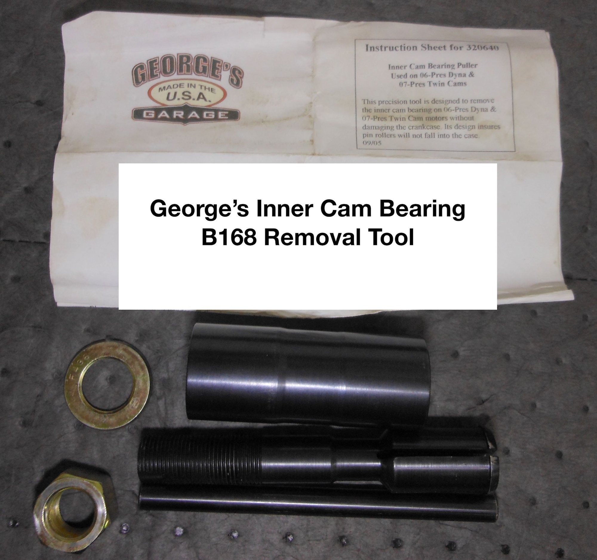

When it came time for the B168 bearing cam chest, I had discovered George's tools. He makes quality tools on par with Jim's, just at a cheaper price point. So I bought the George's B168 inner cam bearing removal tool. It is the same design as the Jim's, and a bunch cheaper. (Jim's @ $325 and George's @ $96)
The George's tool performed every bit as well as the Jim's tool. While removing the bearings, both felt very solid. The bearings came out without any trouble, smooth as silk.
The Jim's installer tool worked very well. It uses a plate to install the bearings just like the Heartland tool. The Jim's tool, however. doesn't have the window like the Heartland, so it's hard to see what the tool is doing. I probably should have kept the Heartland for installs, and used the Jim's/George's for removals. I could have saved the $225 cost of the Jim's installer tool.

If I was tool buying now, with the benefit of my experiences, I would buy the George's inner cam bearing removal tool(s) (B-148 @ $85.25 and/or B-168 @ $95.50). Then get the George's appropriate size inner cam bearing installation tool @ $82.25. If/when needed I would only need to buy the other sized bearing install pilot for $39.95.
