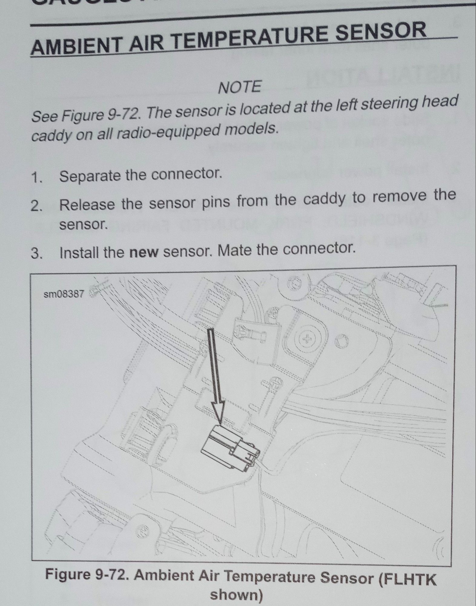

From my 2018 Service Manual.
My 2018 FLHX.

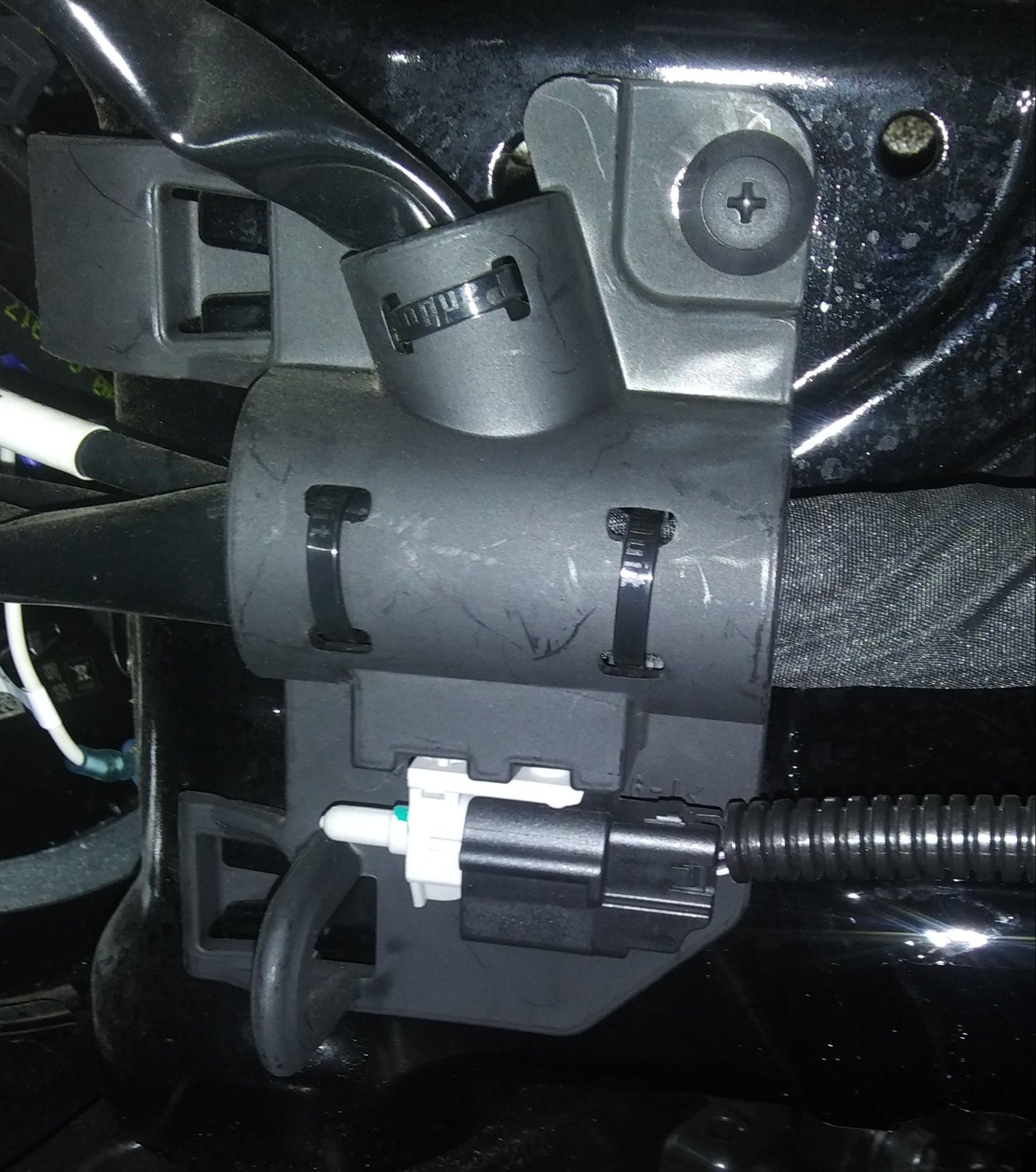

Apparently, my ambient air temperature sensor doesn't require calibration. When I took this photo, my bike had been parked in my garage for several hours.
My ACU-RITE digital thermometer which has proven to be accurate, confirmed it was 72°F in my garage.
Also, I have EITMS disabled because I rarely find myself in conditions where it would be beneficial. For those that choose to enable EITMS, activation/deactivation is dependent on input from the ambient air temperature sensor. I could be wrong, but I believe the factory predetermined minimum ambient air temperature required to activate EITMS is 80°F.
So in other words, while some may claim knowing the ambient air temperature is useless information, it's useful information to your ECM.
