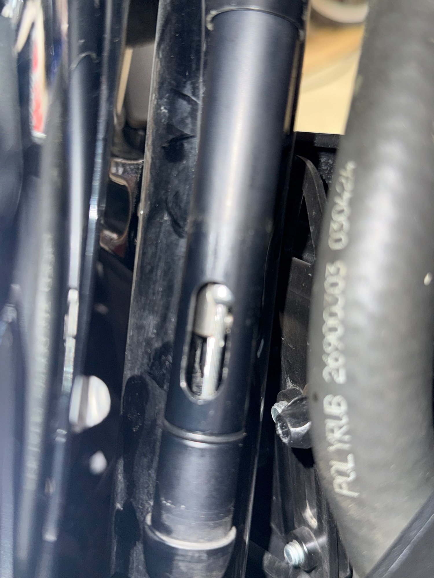

Originally Posted by rideonva
Well, as promised
Lower and upper parts connected
So, the connector in between the new adjustable upper cable and the OEM lower cable is still the OEM coupling? Or FBI's connector, or something similar? Hard to make out in the pic. Does it just add another adjuster to the set up?
I'd like to fine a one piece cable with an adjuster at the lever, like yours, to replace the whole kit and caboodle. Any connection is a possible point of some degree of failure. Just like in the electrician world, any splice is a possible point of failure.......

No, FBI has it's own coupling. Yeah, one piece would be nice, the downside is that replacing it would be much more involved.

Yes, I have the FBI coupling installed on my 22 SGS. it's better, but....... So you still have the OEM coupling set up?
Not sure if you mean "principle" or "parts" when you say coupling - FBI cable has its own coupling on the cable, but same principle to connect to lower part.
Looks like post #9 was mine. What info are you trying “to pull” from me 😀 sorry I might have missed the question. Install is pretty simple, similar to a different adjuster you disconnect OEM plastic one, pull clutch lever off and pull the cable out of it. In my case I’ve also had to open the primary and loosen the clutch adjuster, so that lower part has more slack.
Remove original cable, route the new one. Connect two parts and slide a cover over it.
Reinstall the clutch lever. Adjust clutch to your liking (half to full turn). Adjust free play at the perch. Enjoy.
I’ve had this setup on my 24 for about 7k and now on 25 for 6700. Love it, I have lowers, so adjusting free play at the perch is God sent.
I ordered the upper fatbaggers cable for my 2024 Road Glide and would like some installation feedback from your experience.
I have the factory service manual and step one is remove the outer fairing. I honestly cannot see how that will free up additional space to route the cable. It looks like that even taking the outer off, you are still blocked by the inner fairing. I Do think the nacelle around the bar risers needs to come off.
I’m not opposed to taking the outer fairing off but would prefer to avoid it. I had the fairing off several time on my 2012 and it got pretty good at it, so not afraid to do that step if needed.
Give me any advice you can based on your experience.

No need to remove the outer fairing for RG, I've only removed nacelle and it should give you all the access you need. Cable is routed in the channel on the right side of the frame head and also kept in place with a P-clamp under nacelle.
