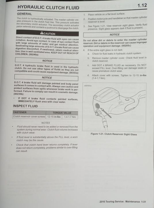

I don't have a 2014, but I do have a 2016 Touring Service Manual, which is still a Twin Cam Rushmore bike....
Is this what you are looking for?

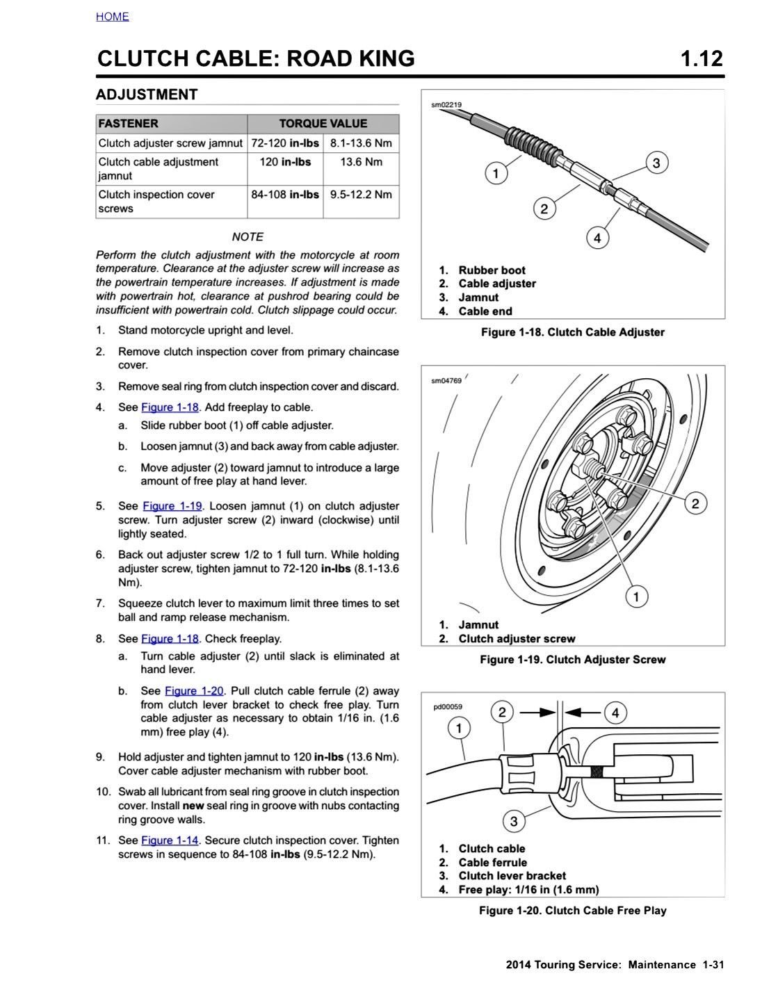

Looks like your page 1-31 is page 1-32 in my manual, so maybe it's page 1-30 in yours. It's the clutch adjustment I'm looking for.

That's it. Appreciate it!
