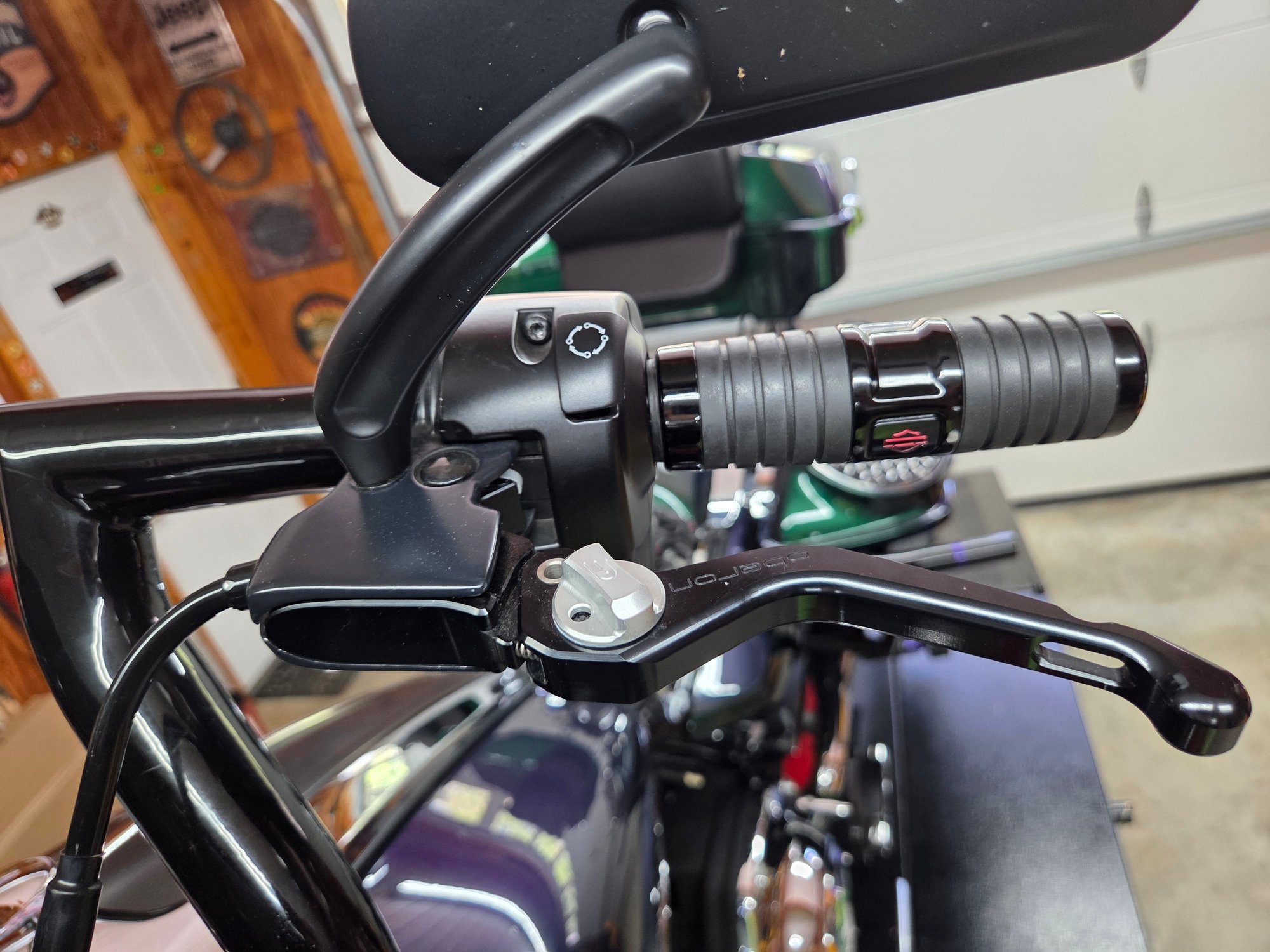

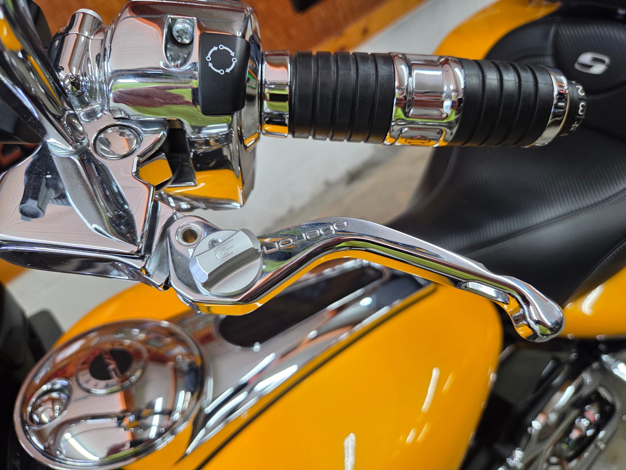

I am shocked by this. I ran them on my 2017 CVO Limited and currently have them on both my 21 SGS and 22 CVO Road Glide.
I have never experience any issue starting the bikes in gear.
They are extremely comfortable to me. They don't decrease the pull but reduce the travel bringing the lever closer.
Personally I love them. Over the years I have heard about this issue but have not experienced it on any of the three bikes.
As for Neutral that is an improperly adjusted clutch. I have mastered clutch adjustment and both of my bikes go into neutral like butter whether running or turned off.
