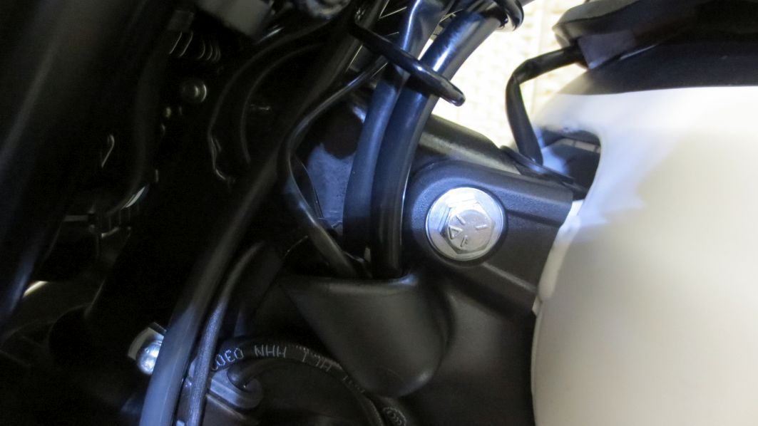

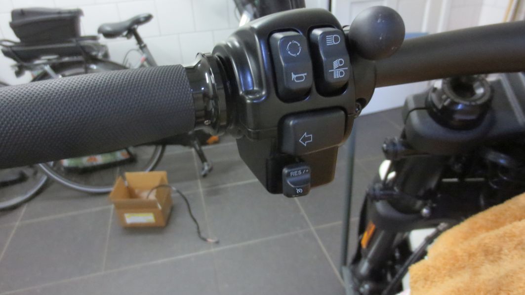

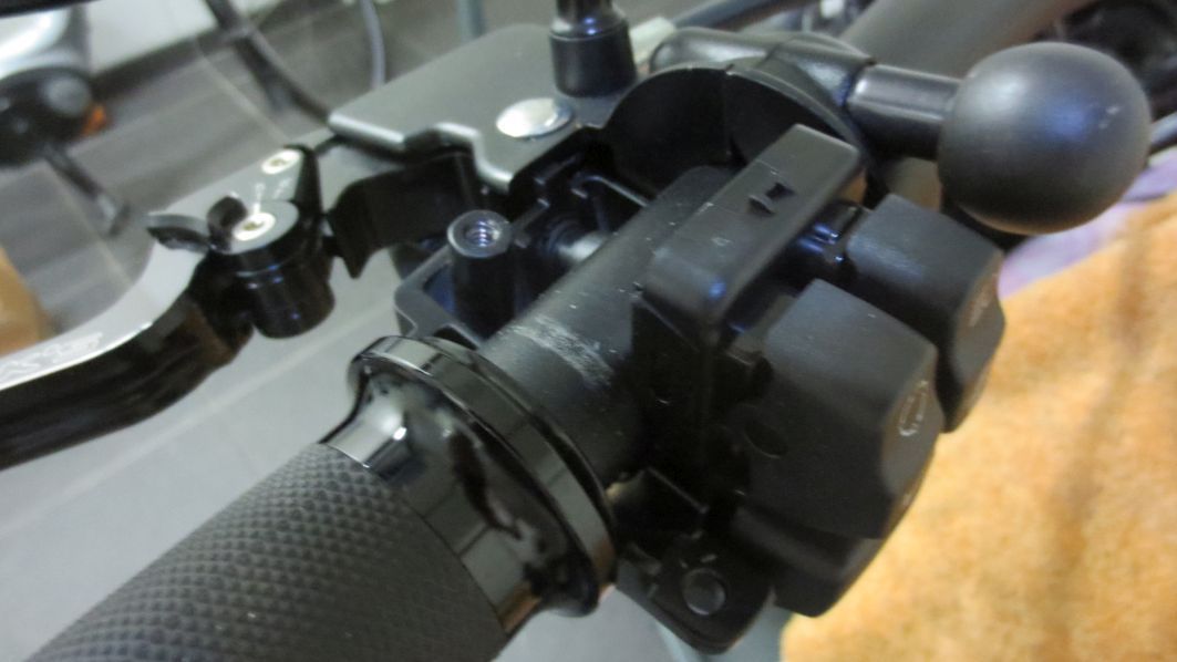

I have already installed it, it took me no more than 15 minutes, including taking my tools and taking pictures, this is by far the easiest mod i have ever done

What I find strange is that there no extra wires comes out of this plug, wonder how this works and whether it is not easy to bridge with a universal switch. I have now disconnected it from the battery and leave it that way
for the night. Tomorrow I will reconnect the battery and do a test drive, this system works at BMW. After disconnecting and reconnecting the battery, additional modules are read into the ecu. Wonder if this is also the case
with Harley.
At BMW you just have to leave it without power for long enough, now that this is not a problem because I have all the software for programming. I am now looking for software / hardware to program Harley, I have already
found something on Ebay and it clearly states that you can activate CC with it and many other things.
The only problem is the cost, now it doesn't matter that it costs so much but I have to import it from the USA and I refuse to give $300 or more to the government for this so I am still looking for a solution not to have to
import it. So if someone can help me with that, that is very welcome.
